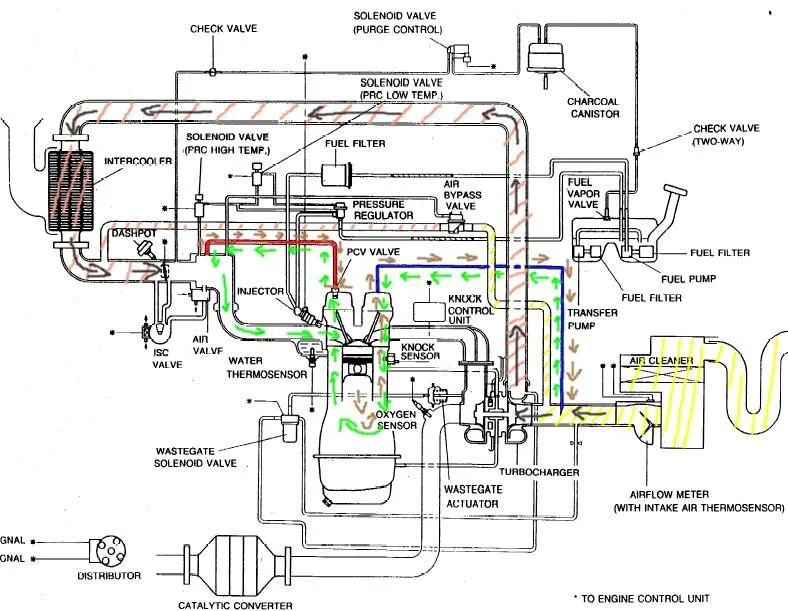

Now that the basic fundamentals are laid down in how the valve itself works, this is how the system works (use the attached diagram borrowed from the BP-ZET routing diagram):
-There are 2 hoses connected to the valve cover. One hose is to the air intake hose (blue solid line), the other hose leading from the intake manifold is attached to the PCV valve (red solid line).
-At high to medium vacuum, the vacuum occuring in the intake manifold system draws fresh air through the blue line hose down into the engine to give it a fresh air supply and then the displaced air (which are the vapors) gets forced through the PCV valve into the "red line" hose back into the intake manifold. The vapor charge shortly works its way through the intake manifold runners into the combustion chamber to be burned. follow the green arrows
-At 1 atmospheric pressure or greater, the PCV valve shuts. The turbo charger has now spooled which means it sucks enough air at the turbine inlet to cause anything attached to be sucked through it. The "blue line" hose air flow now reverses direction and now draws blow by gases from the engine (brown arrows). Due to this phenominon, installing an oil catch can on the "blue line" hose is recommended in order to prevent the intake air hoses, turbine, intercooler, and throttle body from being gummed up with oily residue. This "blue line" hose MUST be installed BEFORE the turbo, otherwise you end up boosting the crankcase!

-With 2 hoses, and the PCV valve still closes at boost, won't the other hose (blue line) create a vacuum inside the crank case during boost? This most likely won't happen since the blow by will create constant, replenshed air flow inside the crank case.
