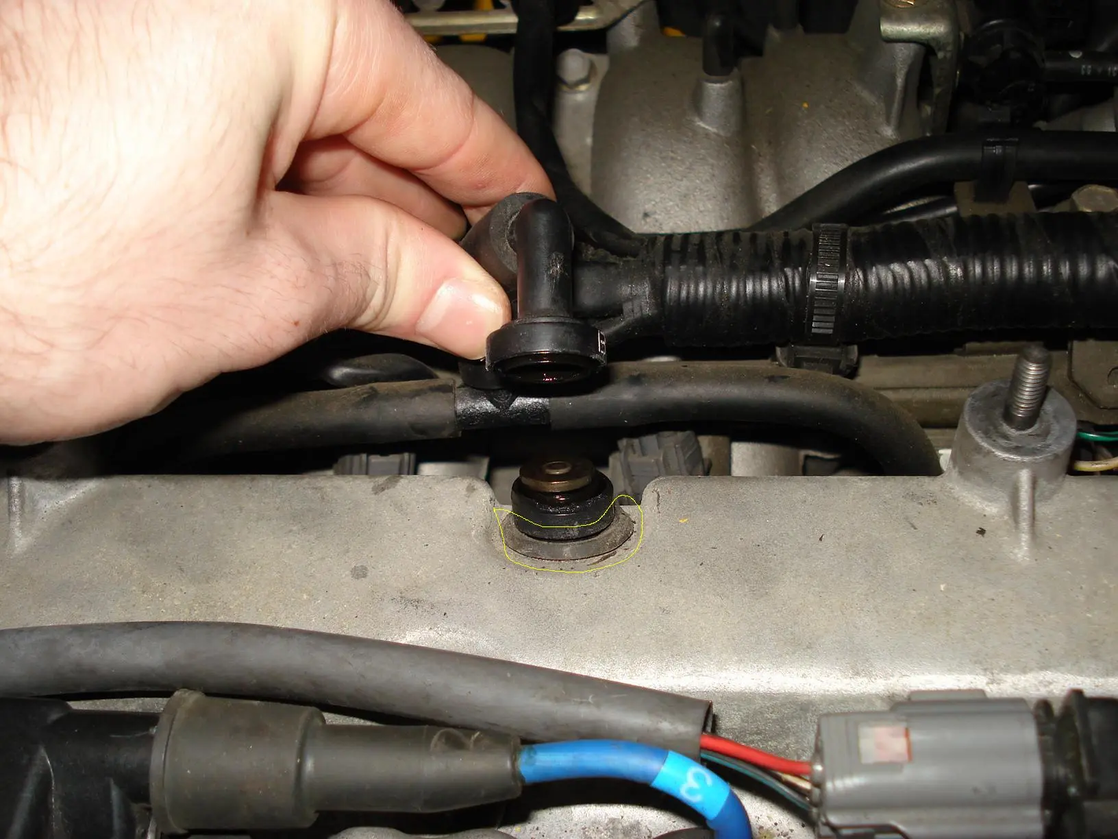

how far down is the pcv suppose to fit on the valve cover? is it enuf that the red is not shown? i cant seem to push it so the red isnt showing and it just kinda sits in the hole loose.
Kansei said:
sits in there loose? did you lose the little gasket that holds it on the valve cover?
If you mean this....yea its still there. I can only get the pcv to go so far down, but i can very very easily pull it rite out....just thought it may pop loose while driving and hitting bumps
Wait hmm.. the PCV in your pic looks broken. Mine hasn't ever separated there, either the whole body of it (including the part sitting in the valve cover in your pic) comes out or it all stays in, including the part attached to the vaccuum line.

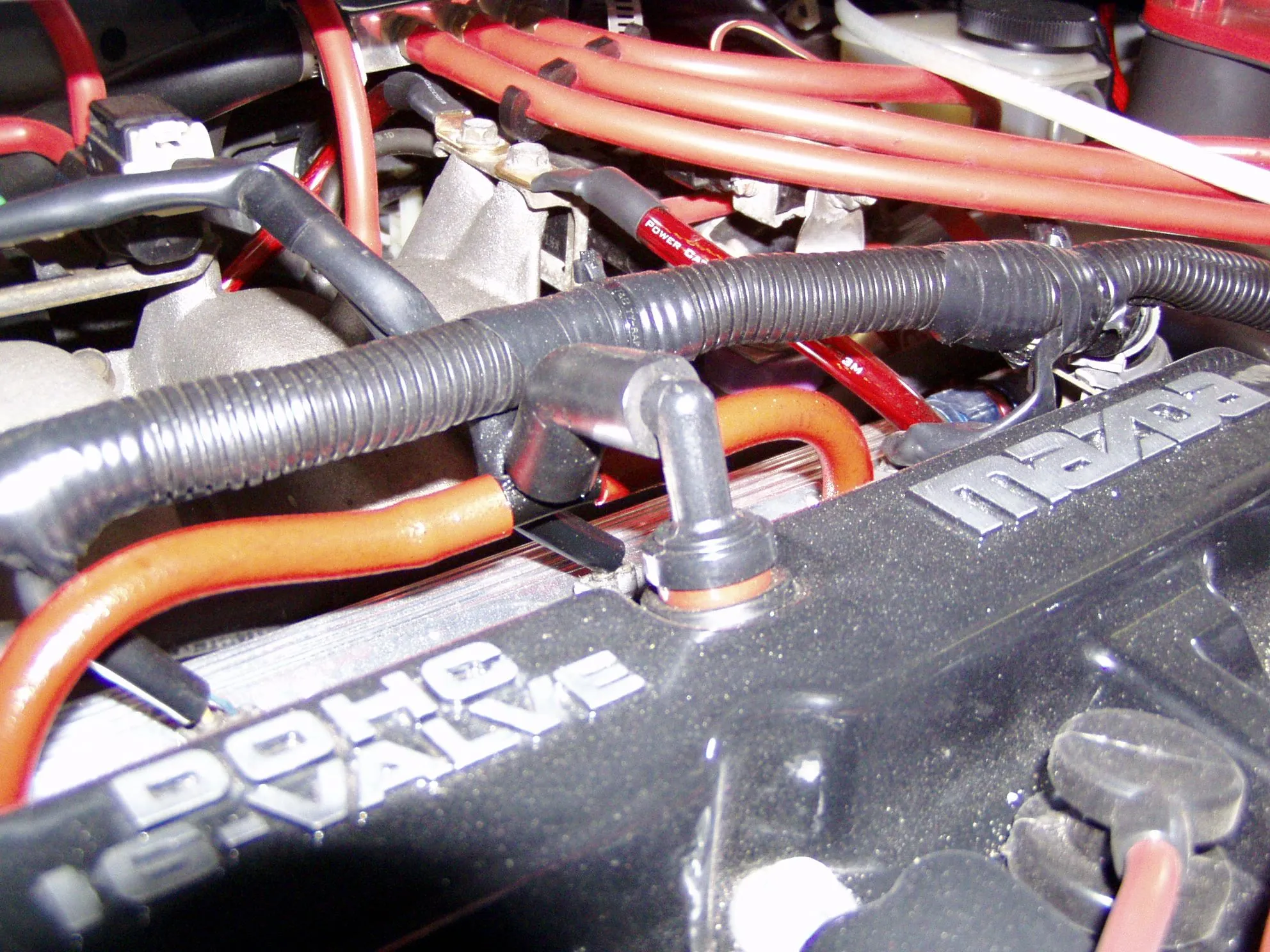

EDIT: Here are the pictures:
This is a very easy install that takes less than 5 minutes (even less for those of you without the plastic valve cover).
And here it is installed in the stock location. A DIRECT FIT!!!
Does your fit in there snug with the red exposed? Mine just seems very loose looking like that.
mine is like this and sits fine and tight?
If it is really loose, you need to replace the rubber seal that goes in the hole. I had to when I replaced mine.
Ya, oil getting in that seal makes it easy to come out. oull the seal, and clean oil off both the valve and the seal. Should stick btter.
I tried pulling it out, but ended up chewing it up...gotta replace now
