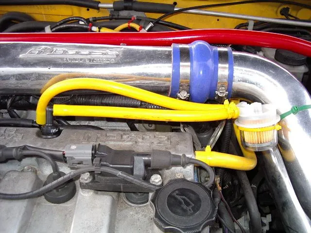

I know YP5 Toronto said that no catch can was needed when using the Millenia PCV valve but that was back in 2004 and I was wondering if anyone using both the valve and a catch can for a longer amount of time now has noticed any oil in the can? Basicly I just got the Millenia PCV valve and put it in but I am still trying to determine if I should still hook my oil catch can up? If not I am going to use it as a coolant catch can. Any updated info or opinions is appreciated
im going to be running this exact set up soon. i fugure, it cant hurt. i mean hell, i already have the catch can, why not use it. just run the two lines coming from the pcv valve it self and the line that the pcv connects to directly to the catch can and use the intake hose and run it to the intake and to the side of the vavle cover (whatever that is called) IF that just made any sense... as shown here:
Tzar177 said:
where can i get a catch can like the one above ^^
i really wouldn't call that a catch can...any auto store will have them..fuel filter
you didn't really read the original post did you? :rolleyes:
was at pep boys today...didnt see anything. did see something similiar in a metal can...but then u wouldnt be able to see any oil
bazooka joe said:
i really wouldn't ca;; that a catch can...any auto store will have them..
