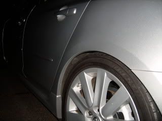

I'm kind of at a loss right now. I adjusted the springs down to the lowest setting (collars threaded all the way down) and then by hand turned the shock body all the way down to the lowest point. It stopped with about 2 inches of threaded rod remaining. With that the rear is still only just over an inch lower than stock???
fronts go lower than the rears with the BC setup. BCs will only allow for the rear tires to sit flush with the qtr panel, not tuck.
which is a total bummer.. it seriously sucks, i wish id got the H&R's for that reason, but im not going to trade them out now.

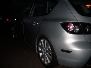

can u get a rear drop like this with bc's?
