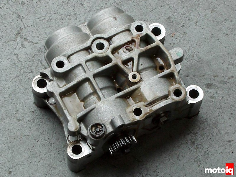

Back in 2003-2004 I removed the BS from my 2003 Nissan Sentra SE-R Spec V . I gained 5-6 MPG’s on the QR25DE motor (2.5L 4 cylinder). There was a little Power gain about 8-10 hp. In addition, it took about a qt more oil due to the extra space created when deleting the BS. There was ver so slight vibration around 3.5k RPM’s . And between 0-10 scale, I would say the vibration was around a 1-2 depending if you are very sensitive person.
Difference between the Mazda 2.3 Balance Shaft and Skyactiv-g 2.5:
From my observation, the 2.3 Balancer Unit can be removed simply by unbolting and dropping it. The Skyactiv-g 2.5 motor can not be deleted the same way. Unfortunately for us 2.5’ers , the Balance Shaft is Spun with a chain that is shared with the Oil Pump. See image below.
