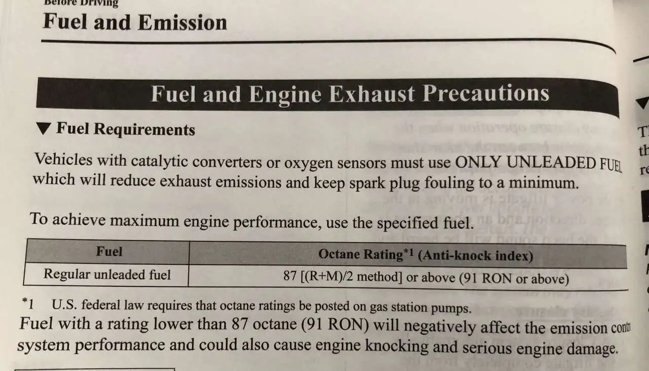

I get the same answer from every reputable mechanic and as well , the owners manual- attached ( which is ambiguous for a reason ) stating in the 2.5NA 22,23.24 ( same as other years) runs on regular unleaded fuel 87-91 octane , and thus when you speak to an educated Mazda service writer - which I have - they will tell you the higher compression 13:1 compression ratio engine in the NA will deliver more power and better gas mileage on premium fuel. Here a guy whos well known for his straight talking advice which I almost always agree with ....and he says that you should use regular 87 on most everyday car gas engines in our biggest makers ,, Toyota , NIssan , Honda etc ...EXCEPT ..he leaves out MAZDA and states " with a few exceptions" such as vehicles with HIGHER COMPRESSION engines. Its good to debate these things as its the #1 most asked question of mechanics - HE also states that you should follow whats on the gas door --which on the CX5 NA there is no sticker saying either 87 or 91 , but in the OM its there ,,,that 91 is included ...hmmm ..wonder why ?
Will it run on 87 ? Yes - Just less power less mpg -
Last note -- if one reads the fuel rec page ( which I attached )fuel below the 87-91 minimum fuel requirement... states that fuel BELOW 87 octane can cause " engine knocking and SERIOUS ENGINE DAMAGE " ...so if you are using 87 and the fuel happens to be just off by a slight amount below 87 ...then you are potentially causing serious engine damage ...so why not air on the side of caution and at least go 89 and my argument is for 91 0r 93 if you have access to it .

Just to clarify.
The image you attached refers to 87 octane or above (91 RON or above). RON (research octane number) is used in countries such as Europe, Australia and New Zealand, among others. US, Canada, and Mexico use AKI, which is the average of the RON + MON. The AKI is represented as octane rating at the pump. This means that 87 octane = 91 RON, and the manual is stating that 87 octane or above can be used. So yes, you can use 91-93 octane (which is 95-98 RON) in a car that is designed for 87. However, any benefits that might come from the higher octane are a wash at best. You'll get a few more miles out of every tank but you'll also be paying more per fill. Maybe an extra $100-200 per year to run premium fuel in an engine designed for regular, to slightly reduce the chance of engine damage from a problem the car doesn't have (engine knock - something it is not known for).
Ok we somewhat agree -- yet the " car " was not designed to run on 87 ..it will run on 87 -- it has more power , less knock potential and better fuel economy on 91-93 and is a high compression combustion engine which is unlike all other vehicles in its category- It is capable of running on anything ABOVE 87 so it recognizes the fuel type and adapts accordingly - 87 being the absolute lowest octane it will operate on without potential serious complications
- The information on high compression engines shows 91-93 ( premium fuel ) demonstrates improved overall performance/ mileage --( yes more $$ ) - so if you read the caveat below the 87 rec, it states that fuel below 87 can cause knocking and potentially serious engine damage - so why " walk the line "
at the edge of the damage zone ? What if the fuel has somehow been processed or is in a condition of being 86.9-or lower ? ( an example )- then you are risking damage ....correct ? -- forget performance or gas mileage ..staying on point ...or the " edge " of point -- Why not go 89 and remove that risk --if you think 91-93 is not warranted ? This is definitely about gas mileage -- as its cost per mile based on fuel choice -- I suppose the performance debate is off topic .. I see fuel costs pretty low now compared to 2 years ago .....and Im getting 91 top tier around $3.42 -89-$3:20 87-$3.09- chevron, texaco ..shell is a bit more

Ok we somewhat agree -- yet the information on high compression engines shows 91-93 ( premium fuel ) shows improved overall performance/ mileage --( yes more $$ ) - so if you read the caveat below the 87 rec, it states that fuel below 87 can cause knocking and potentially serious engine damage - so why " walk the line "
