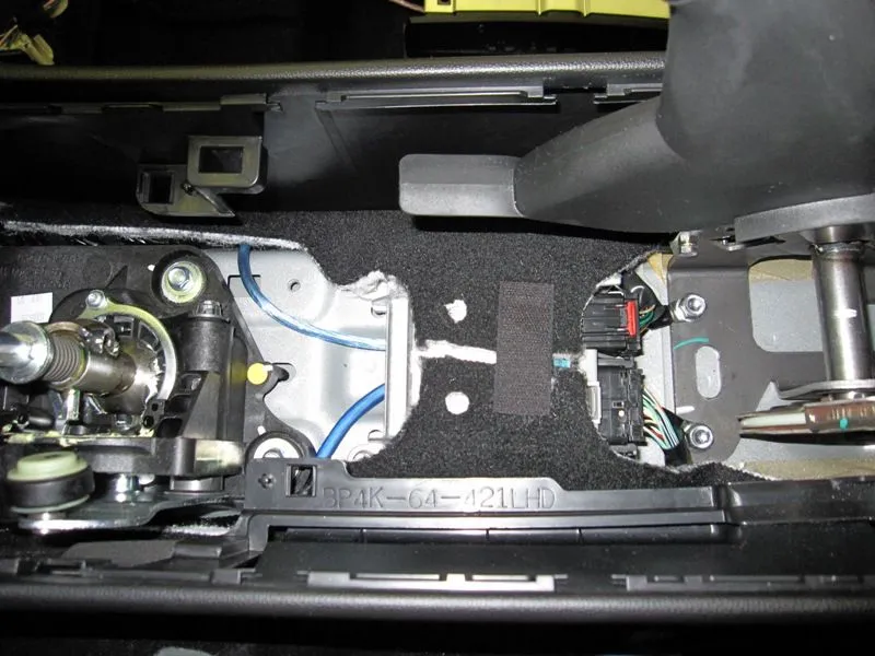

I tend to agree...on my recent install-I made sure to keep the power and RCA lines separated. RCAs are run down the door sills, power is run down the center console. I'm running two JL Audio amps (250/1 and 300/4) using the stock battery and I have no whine, no power dips, no dimming lights, etc.
I think it has more to do with the wiring quality/placement and quality.
The attached pic is of my ground wires in the center console.

sounds like wiring
You would need way more amp than that to bottom out your alternator. Like has been said before, keep signal wires away from power leads. I'd check voltage drop across the amp's power lead. Keep your ground wire as short as possible, and keep it the same gauge as the lead. At least 10 AWG, and probably 8 if it is in the trunk. Good fuseing and connectors also help to limit voltage drop.
If that is in order, go for a better battery. IMHO you don't need a cap or upgrade alternator with that amp. I have done many installs!
