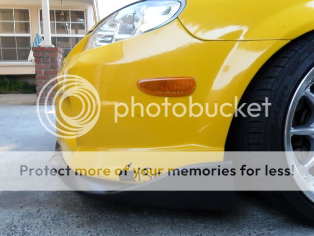

well, I mounted my chargespeed lip yesterday. theres good and bad about it.
the good: its on there and looks good when viewed straight ahead. lol
the bad: the end of the lip (where the wing things are) is longer than the actual bumper. so the lip sits a little closer to the tire than I'd like. It poses no issues other than it looks lame. lol
No matter how much heat you apply, it will not change the fact that you simply can not alter this lip too much without creating a lot damage. Also, when you heat up the lip, it may fit well in one area, but will be completly distorted in an other. I tried everything to get a better fit. Now that its on there a bit better, I will see what I can do about getting a better fit. TheP5 02 bumper is a bit skinnier at the bottom than the MSP lip so its tougher to fit imo.

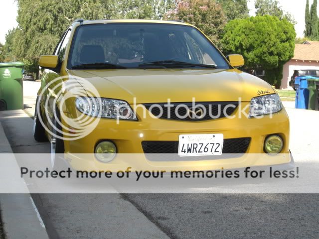

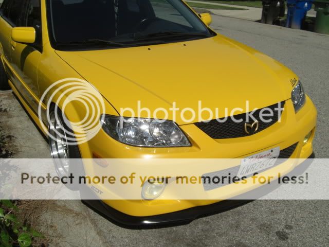

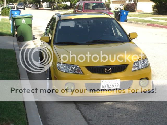

I didnt take pics of the install, but I did take a few afterwards.
So this is just a rough idea on how I mounted mine. If you have more to add, or any suggestions I'd like to hear them.
Heres a few pics, like it or not, and a short video of how it looks.
