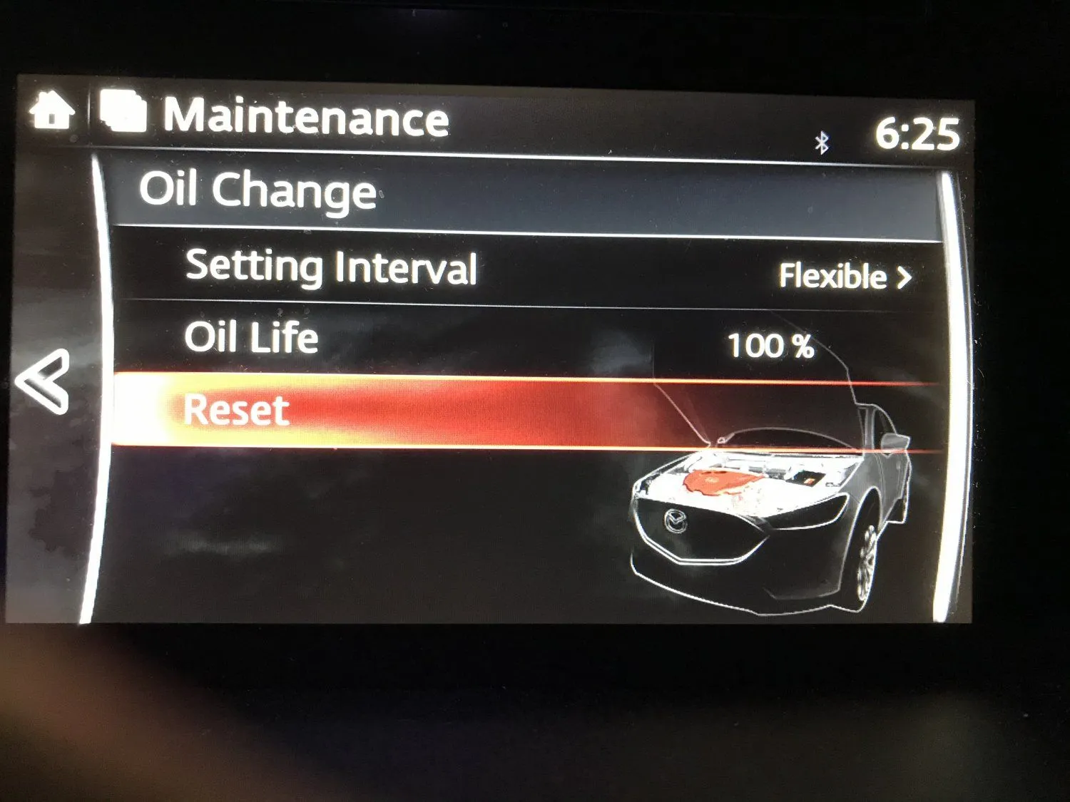

Just so you know, Flexible oil change schedule is applicable to both Schedule 1 (normal driving conditions) and Schedule 2 (severe driving conditions). Just trust the calculation of your oil life monitor and do the oil change when the wrench indicator displayed with “Oil change due” message. The Flexible OCI is UP to 7,500 miles or 12 months whichever comes first.
Judging by 4,000 miles on your oil life remaining from Flexible oil life calculation with 3,300 miles driven (7,000 - 3,700 miles at the first oil change), the countdown miles starting from 7,500 miles after Flexible OCI reset on oil life is 3,500 miles. So this indicates your driving condition is not severe at all as the countdown miles is only 200 miles more than your actual miles driven. You should follow the Flexible OCI for the best use of oil life. Or if you prefer earlier oil change, you can change the oil earlier with 500 ~ 1,000 miles on Flexible oil life remaining.

This resonated with me, thank you. I also thought the same: I'm really somewhere in between Schedule 1 and Schedule 2, and that's what the Flexible OCI is for....so I turned off the maintenance monitor
??? If you think Flexible oil change schedule is useful, why did you turn off the Maintenance Monitor which has Flexible oil life monitor? :unsure:
I’m probably just using the wrong term - I turned off the first setting (“scheduled”) but kept tire rotation and oil change on.
Yes, that “Scheduled” setting for maintenance schedule is confusing too! I just set it to 7,500 miles for Time and 12 months for Distance as a reference to Flexible oil life monitor which uses %.
