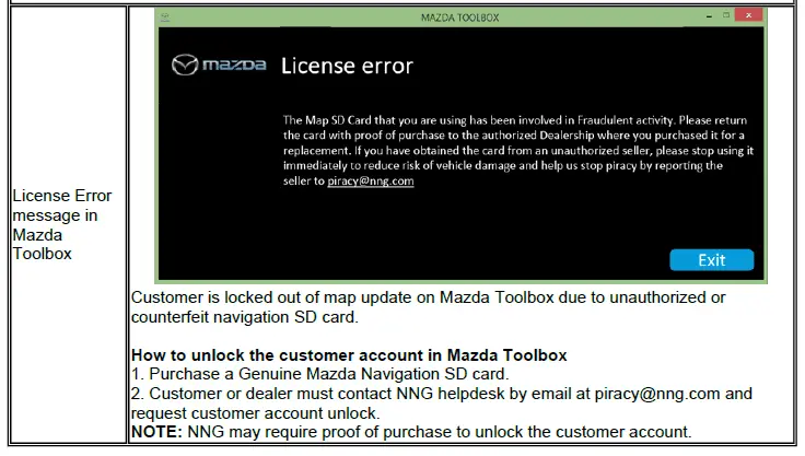

I'm a bit annoyed to say the least. When I try updating my dealer-supplied SD card for my wife's 2018 CX-5 Grand Touring, I get the pirated warning.
This started happening with the most recent update to the Nav software, and happened on the OEM card the car came with (license expired), and two subsequent dealer supplied cards.
Does anyone have any ideas on how to deal with this?

In this case, I can't even make it that far in the process - it pops up every card as counterfeit.
I think it's a software issue with the latest Mazda Toolbox Update.
I have no issue with the latest Mazda Toolbox Update or SD card update.
Try to reload one of your map backups.
Well according to Mazda service alert SA-019/21, your VIN might be locked out now.
See page 1 and 15 in attached Service Alert 019/21.
