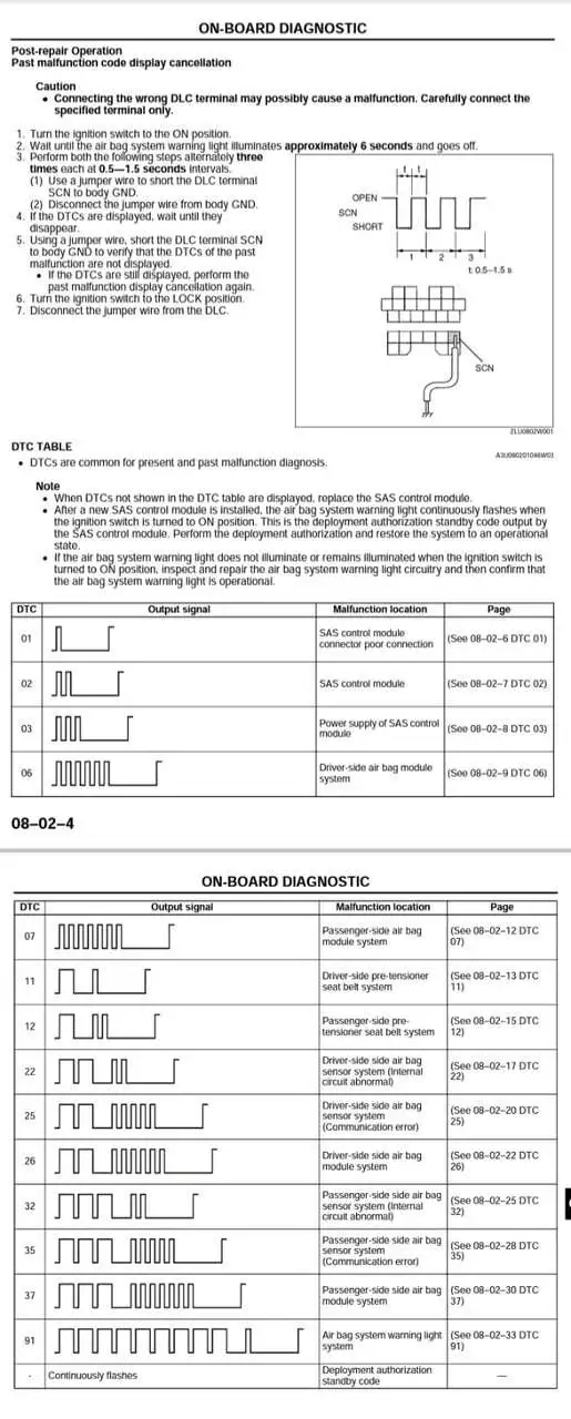

Hi all newbie here. 2002 protege5 . I have a goofy red light blinking. Looks like a#73. Can’t find air bag code anywhere, wtf is it a government secret?🤔. Put my Otc reader on the car no codes. Thanks glad to be here.

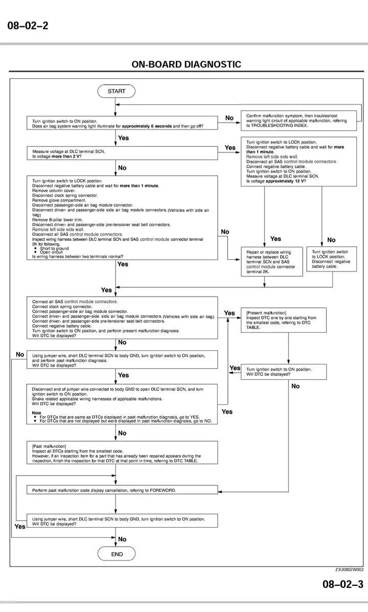

There is a procedure to read the codes,..
Here's a link to the factory service manual.
It's covered in chapter 8
Thanks PCP, while I was gone I did find that info online. Maybe it is reading a #7 then #3. Maybe the codes read in the order they happened?

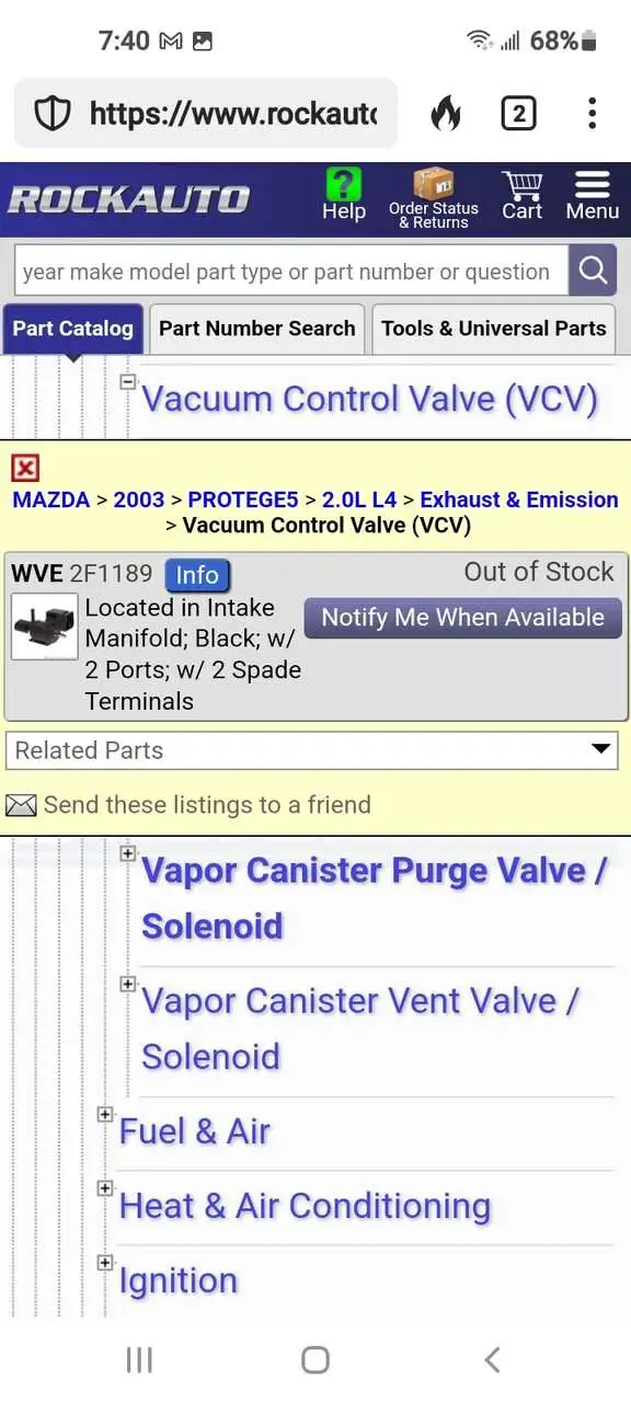

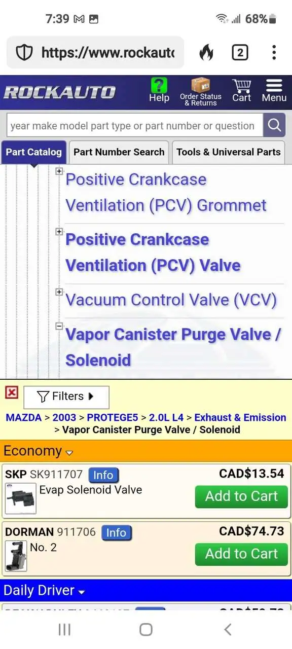

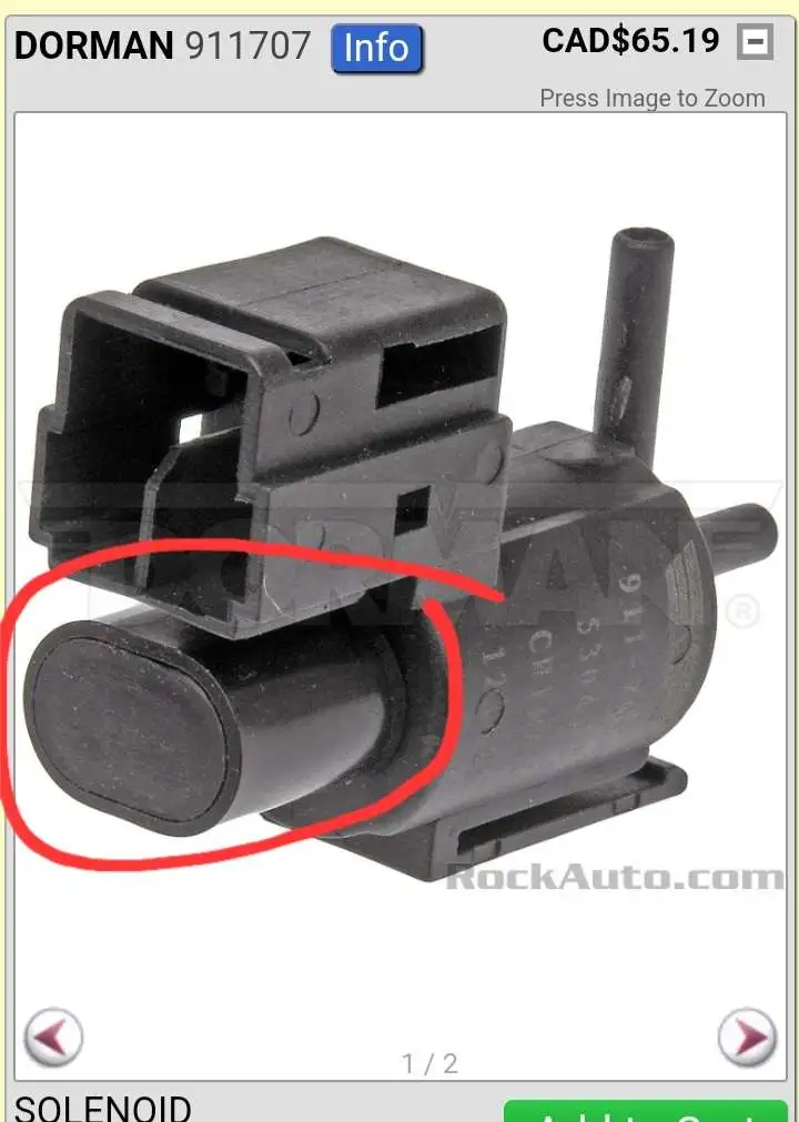

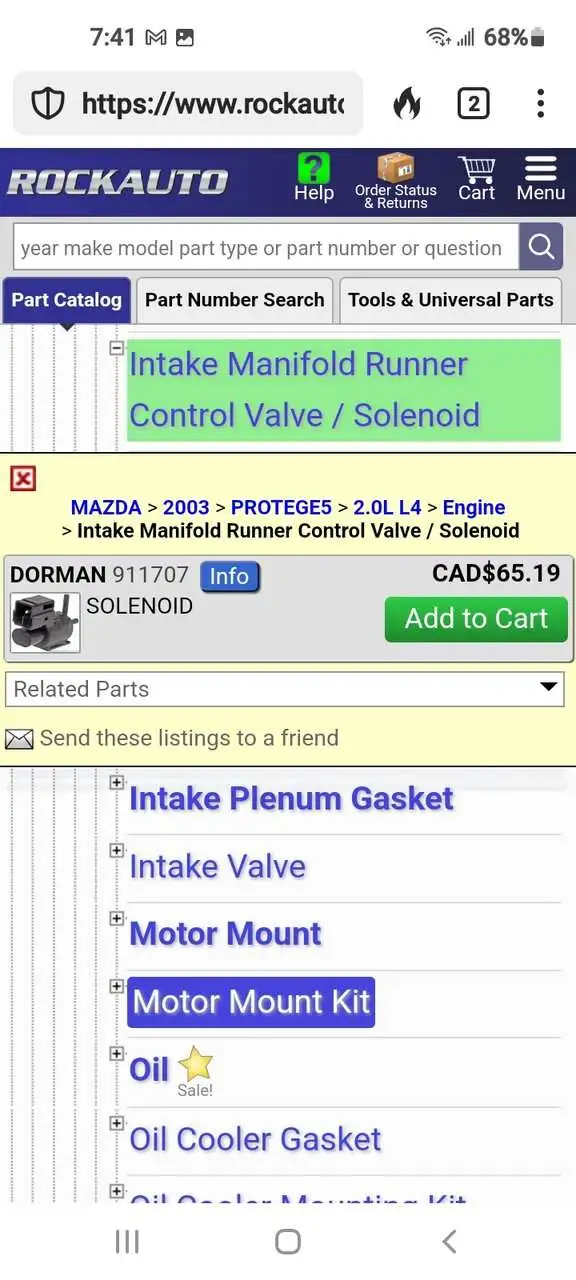

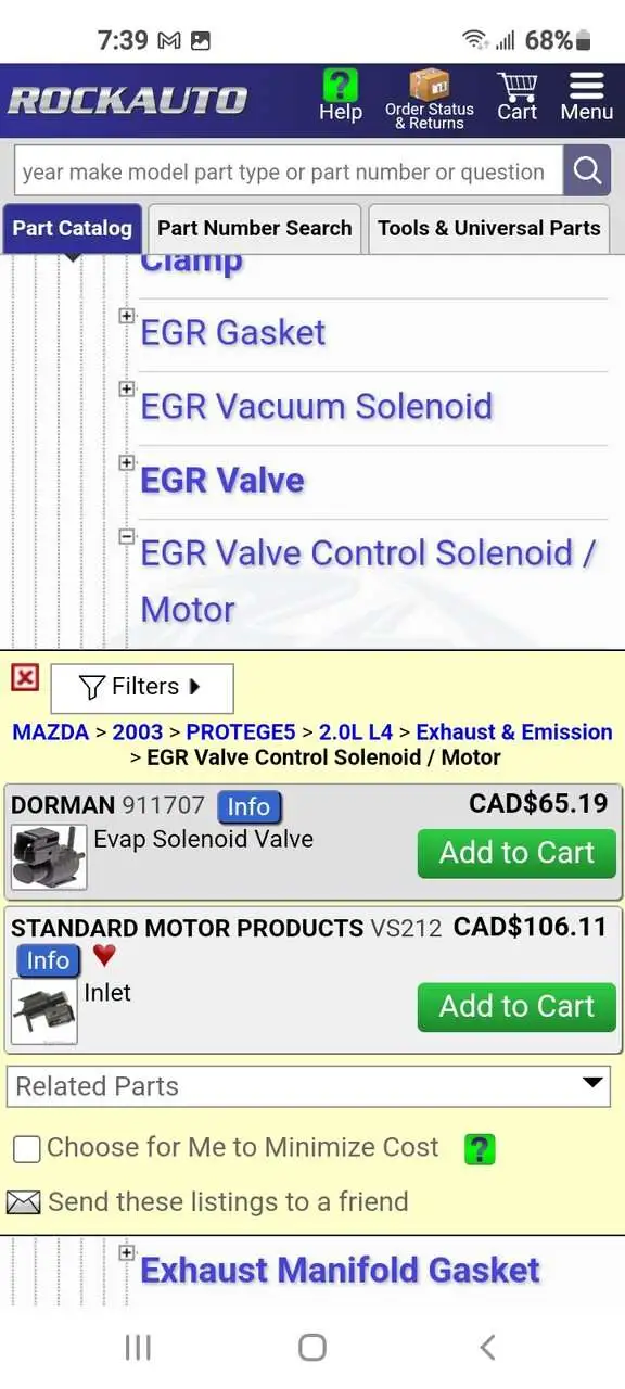

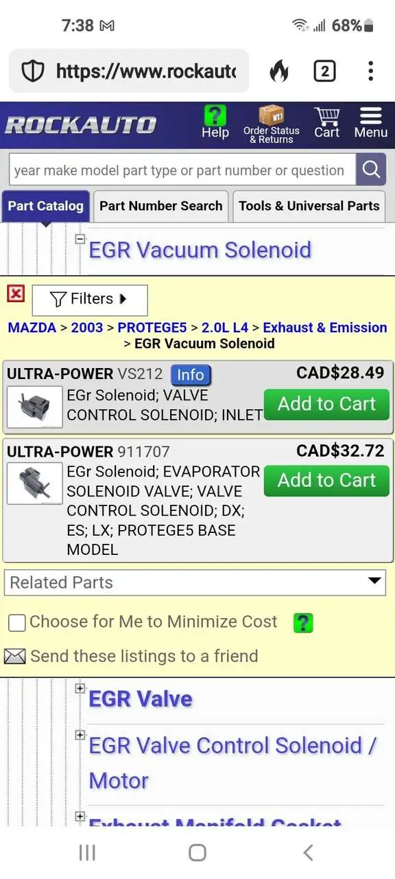

This is what you need.
The $13 one will work and is good enough.
They're all the same except the vacuum hoses may plug in differently.
Get a few. Your going to need them. 😂
This is just an air filter.
You just pull it off and put it on the proper port if the valve connects differently.

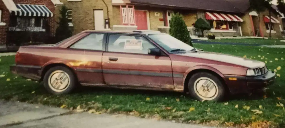

I had a heater hose blow off of my 85' 626 and I warped the head.
I swapped it with the head from my parts car.
I reused the original head gasket and head bolts. 😂
I just sprayed both sides of the gasket with copper silicone spray gasket.
It worked for over 2 years before I sold the car.
(I got $425 for it.)
