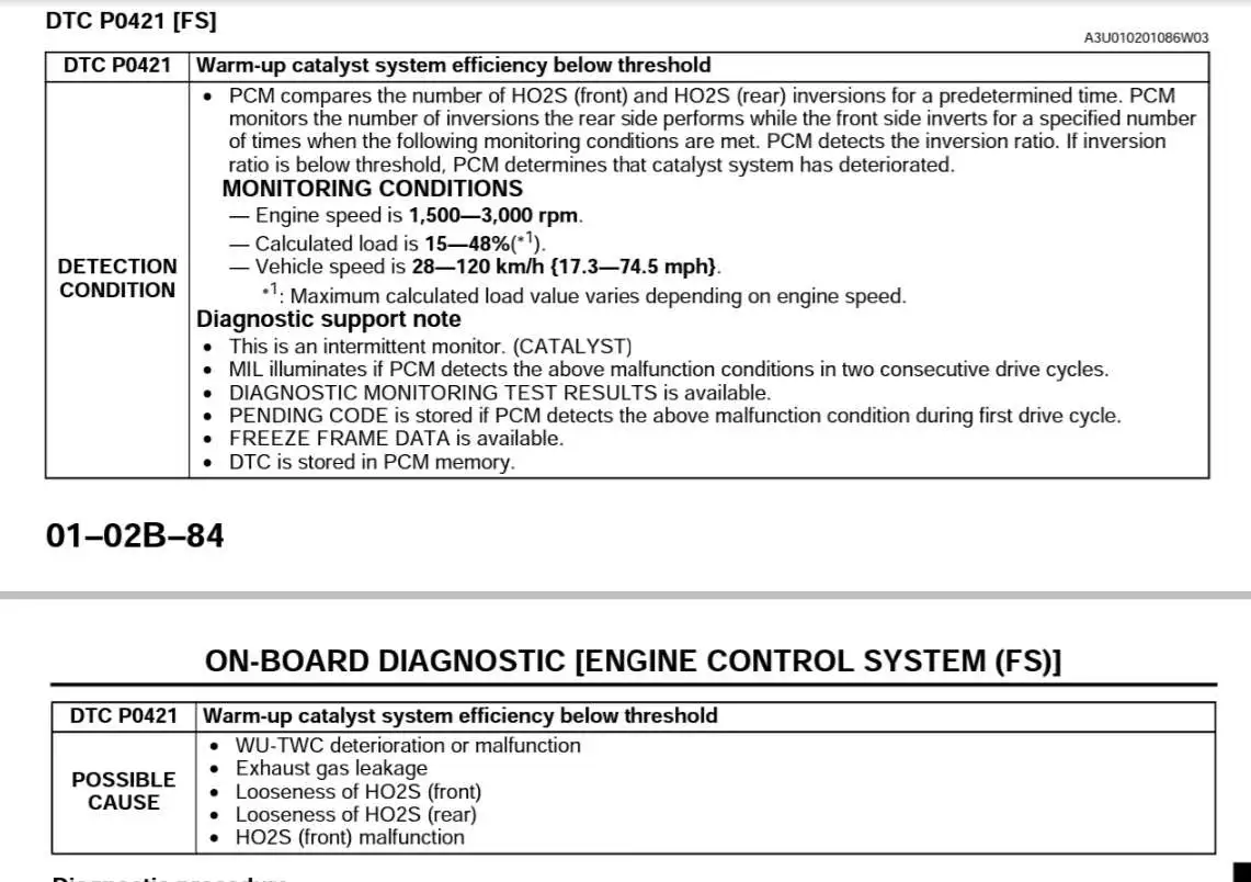

So, I had unhooked my battery to do the Man Trans Motor Mount and after 3000 miles the OBD II checks still are not complete.
I have had a pending P0421 for the last 1000 miles or so. CEL has never come on and P0421 just stays pending.
Any ideas on how to solve this?

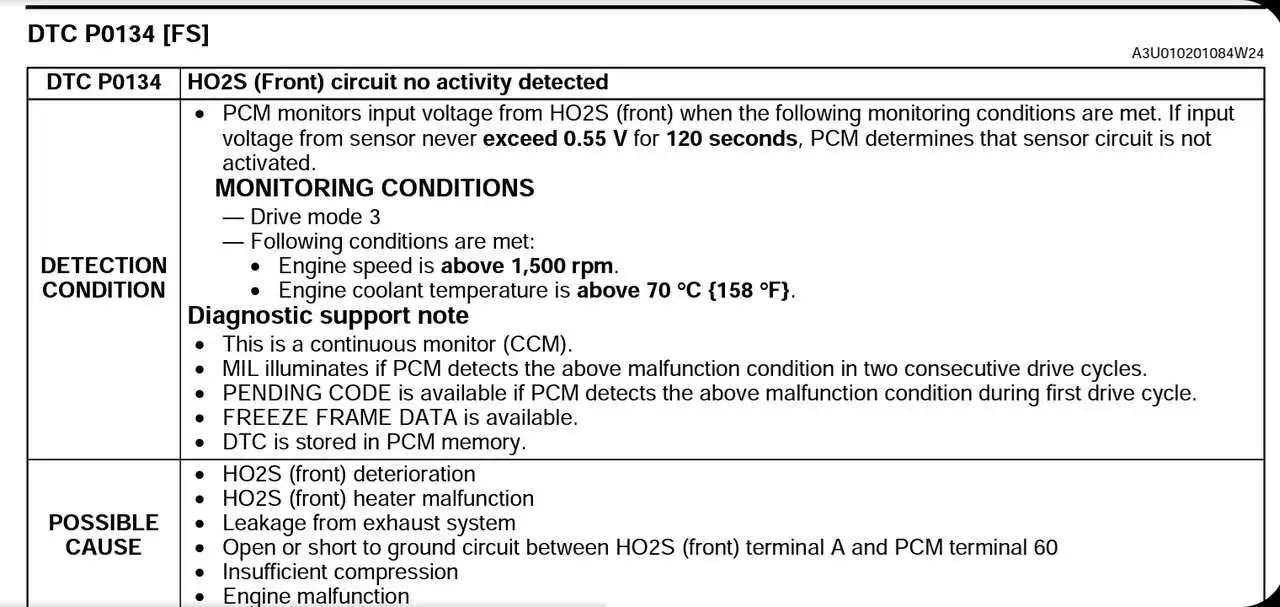

This is what the service manual says,..
You may have a deteriorating pre-cat or upstream O2 sensor.
The code needs to have 2 consecutive drive cycles to turn on the CEL and that hasn't happened yet.
That could mean that things warm up and start working, but I don't know how long the ECU saves the initial pending code.
Try rubbing the code and see if it comes back, keeping in mind the monitoring conditions so you can get it to test.
Then the next best option is to replace the upstream O2 sensor.

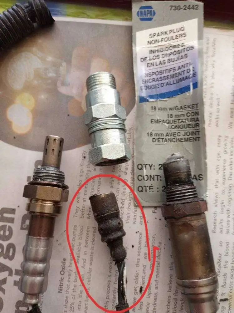

Cut the wire off the old O2 sensor, and/or smash the ceramic end off the old sensor so that you can fit a deep or regular socket on the sensor.
An O2 sensor socket has a slit in it for the wire, but there can be so much torque on the socket that it opens up and strips the sensor flats.
You can install the new sensor with anything, even an open ended wrench.
Some antiseize on the threads is a good idea, especially if you have to remove it again to install it in a non-fouler.
Make sure that you buy a sensor with a smaller end on it to fit your non-fouler if you end up needing one.
This is the part that I broke off my old sensor,..

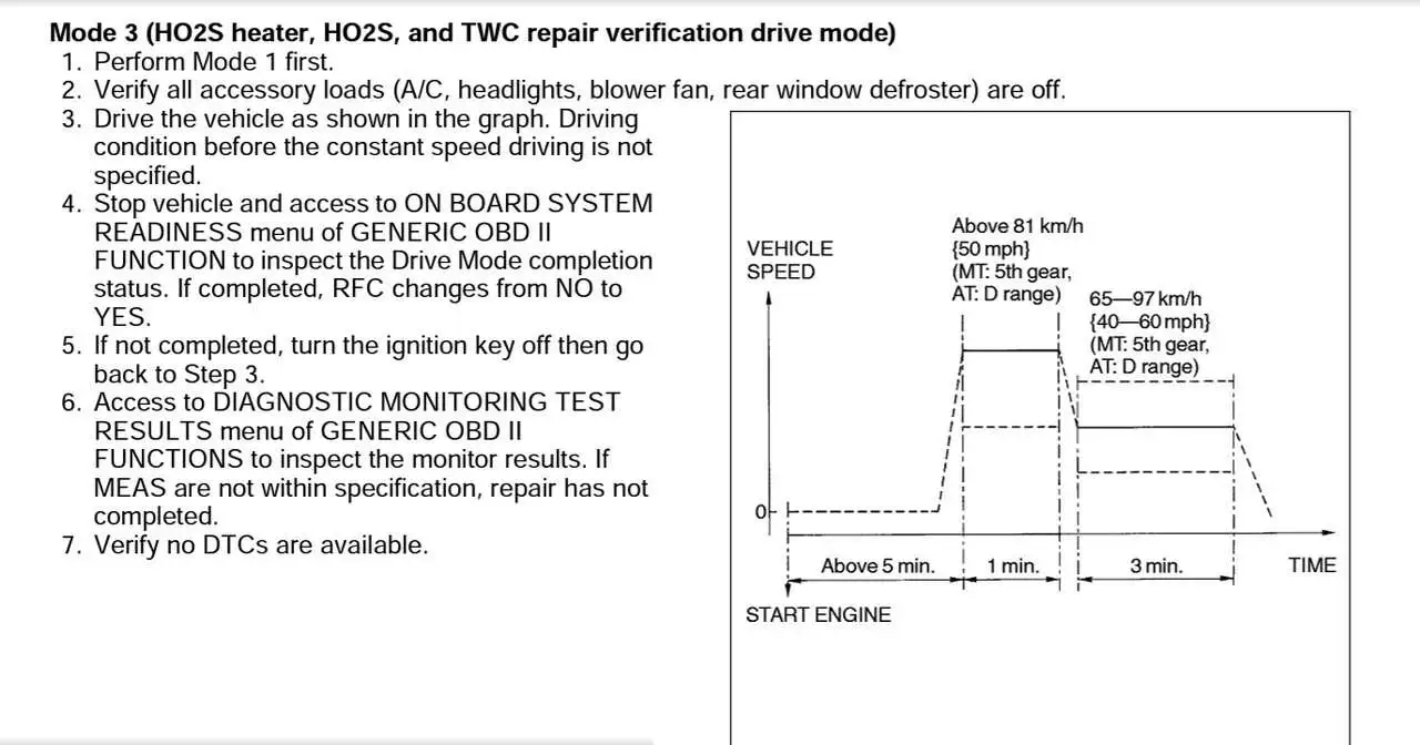

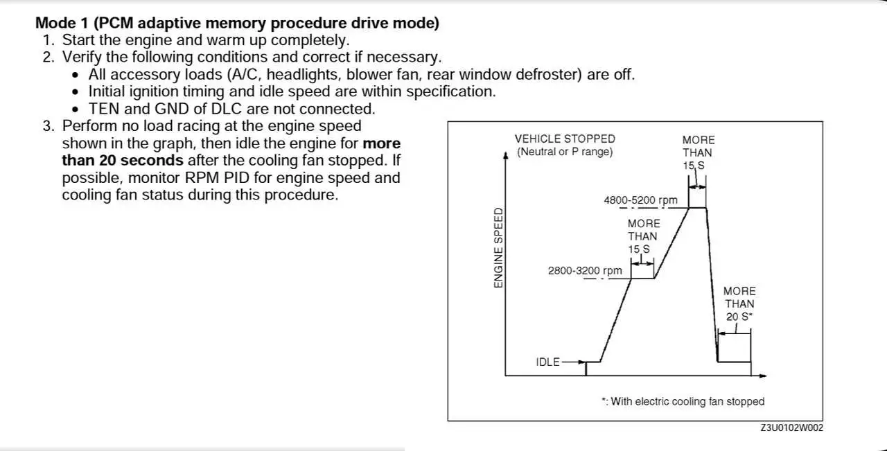

Yes, here is the drive cycle....
Mode 1
1) Start vehicle andhttps://www.ebay.com (commissions earned) min.
2) Rev engine in neutral or park to 2300-2700 rpm for 15 seconds
3)Rev engine in neutral or park to 3800-4200 rpm for 15 seconds
4)Idle engine for 20 seconds with cooling fan stopped.

Mode 3 (H02S heater. HO2S, and TWC)
  1. Drive Mode 1
  2. Driving condition before constant speed is not specified
  3. 50 mph for 1 min, 5th gear
  4. 40-60 mph for 4 min, 5th gear

I followed this,..
The hardest part for me was revving the engine at 5000 RPMS in neutral for 15 seconds.
That just seemed so wrong.
How to blow up your car in 15 seconds flat !! 😂
That's an Italian tune up and is probably a good idea to be done every now and then to help clear out that EGR.
Yes, that is drive mode 1. I did that and then if you look at the other drive modes they are all drive at 50 in 5th gear or 40-60 in 5th gear, or accelerate up to 40-60 and then drive in 5th gear.
