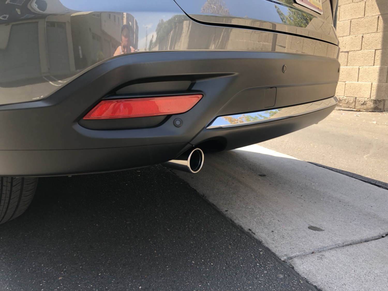

Thanks everyone for the input on this tread. I pickup the same tips on eBay (cheaper than amazon). I did not have prime account. Here they are:
https://www.ebay.com/itm/Vulcan-X-E...e=STRK:MEBIDX:IT&_trksid=p2057872.m2749.l2649
Btw, this is for each tip not a pair! So budget that price in.
But what a big difference! This is my wife's car and even she likes it. It did not make the car look rice or silly.
Here are some pics to give you an idea. One of them has only the left side installed to show the difference. Also the corona bottle was included to show scale:

Any tips or tricks on installation? I know they just slide on and you screw them tight, but how about getting them lined up properly, any tools to make screwing them on easier, etc. They look awesome!! I've had mine for a few weeks, just haven't had the time to put them on yet.
Thanks for the post, especially the before/after shot!

Great! Glad it all worked out. I think this is how it should have come as factory. The existing tips are too small and not in scale of the size of the cx9.
