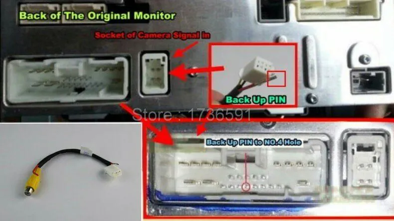

Hi Lads, searching In aliexpress I have found that apparently the nb1 multimedia has a trigger pin to switch on the vdeo input. Please see the attached picture. Someone have tried to use this input before?
CU!
Enviado desde mi XT1032 mediante Tapatalk
