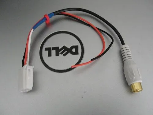

I am selling this backup adapter alone on ebay (281431090970). Please let me know if you are interested.
attachment.php

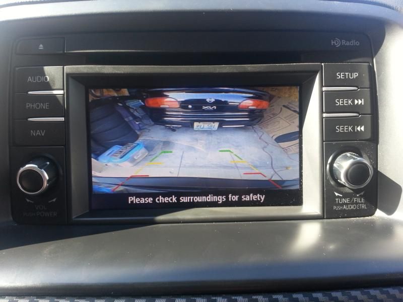

I just completed the camera install for my CX-5, and it came out great. When I was looking to do this, I didn't see one complete resource or "How-to" so I'm going to try to give you some pointers if you're thinking of doing this.
If you want to test if your CX-5 stereo will look for the camera once it's installed, try this test: With the car on, hold down the power button on the radio, while pressing the Seek Up button. You'll get to a programming screen. Type in 92 and enter. The radio should now show a blank image and say "Check surrounds for safety" - at this point, the radio is trying to find the connected camera, but since it's not attached yet, the image will be blank. I think all CX-5s with the Bluetooth radio have the ability to add a backup camera, but this is a good test to prove it to yourself.

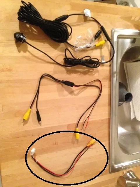

Here is where I purchased the camera: http://www.ebay.com/itm/181230461108?_trksid=p2059210.m2749.l2649&ssPageName=STRK:MEBIDX:IT (From RetracToyota who posts in this forum). The design and cabling was perfect (correct length cabling, no crimping or cable splicing needed, just direct plug and play). The instructions leave some to be desired, but with the help of this forum, all is do-able.

2. Then, connect the cable for the camera to the back of the head unit.
3. At this point, reconnect the car battery, and put the car in reverse. Even though the camera hasn't been hooked up to the back of the car, you should get the image from the camera on the screen. The stereo automatically searches for the camera, so if it's not coming up, something isn't connected correctly - nothing has to be configured (from what I saw with my installation).
