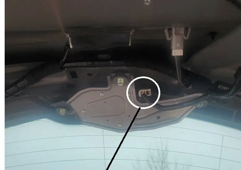

I saw 3 people have success wiring it to rear wiper 12v wire? which I thought was this? I tried and the camera didn't even power on? (Had previously tapped to reverse light wire, diagnostics camera powered on)
