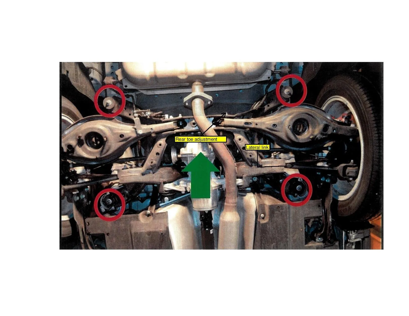

A good picture with the rear suspension, from Corcksport installation manual:
attachment.php
I have added two comments myself.
Nice thing about the AWD is you can lower the rear to the max, and jack at the differential. It's a tight space in there.. I recommend ordering some sway bar lateral locks (approx $30 by Whiteline on ebay) to be installed at the same time as the bar.

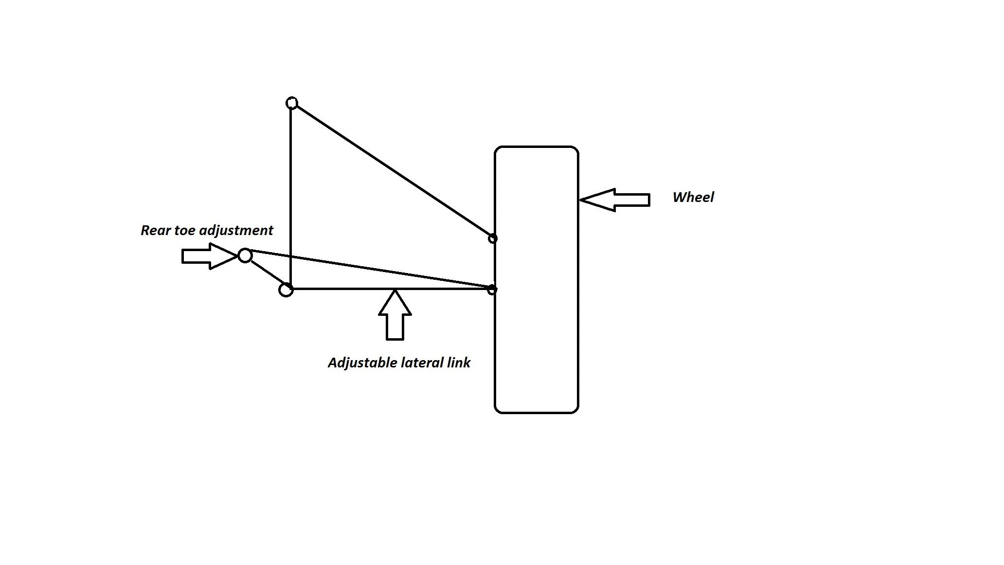

I made a quick drawing to understand better what is going on here:
attachment.php
By adjusting the toe bolt, which has an eccentric cam in it, the whole control arm, can be shortened or extended.
With combination of the adjustable arm that I have made, the rear bottom part of the suspension, can be pulled in or out, this way can be adjusted the camber.

The thing about the toe bolts is it looks to be behind the axles. I assume people are saying that adjusting toe also adjusts camber.. but not individually. Don't see how you could get both to spec with just one bolt.
Well, that's cool. I will definitely buy one when it appears, from whoever. I'm wondering if JBR sourced their new front sway bar form Hardrace (I am probably buying that bar once I take care of some other things first). It's the same design, same thickness. Hardrace said they were working on a CX-5 camber arm for release mid July, which never appeared. Makes me wonder if the JBR item is actually the camber arm Hardrace is supposedly releasing. Either way, the toe arm probably won't give as much adjustment as a made-for-camber adjustment arm, but when your talking 1-1.5 deg it doesn't take much length. Tibimakis self made arm gave him corrected camber on his lowered CX-5, using the same design as the Hardrace toe arm.
I have thought about another reason, why the lateral link is a better option, then a camber arm. Actually Kevin, from the Australian company mentioned this, but I have forgot about it.
If you pull in the bottom of the wheel, you have room for wider wheels(more clearance, between the wheel and fender).
The camber arm pushes out the wheel, so it will be less space between wheel and fender.

With the camber arms, most likely my wheels would stick out. By pulling in the bottom of the wheel, by shortening the lateral links, the top of the wheel pretty much stays at factory position.
