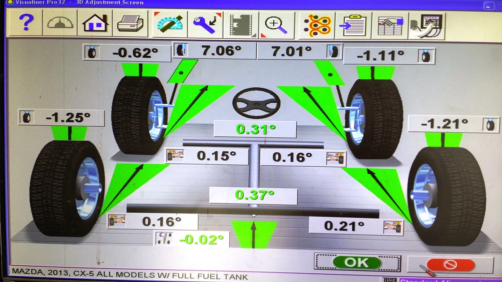

OK, it seems like it's done and to me, it looks good.

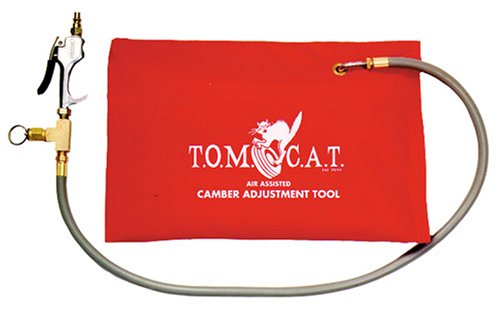

They had to use the air bag tool, on the front right passenger side, after they loosened one of the bottom strut bolts and re-tightened it, after they pushed the strut a bit with that tool, it get closer to the right number. Without using that tool, it was still in green, but it was just borderline.
Yeah, I'm done and I don't have to make the camber arm. It was a cheap fix as well.
Now, I will have to repair the paint, on those messed up wheels.

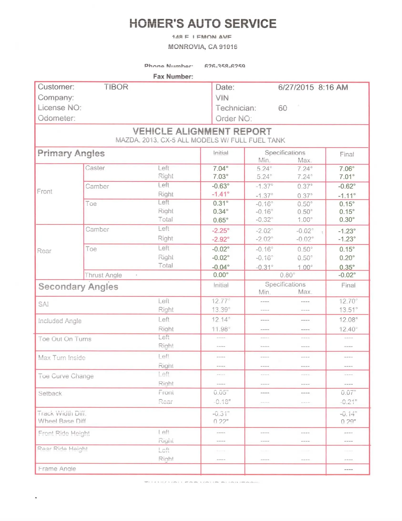

Took a picture with this screen on there PC, it looks cooler then the paper they have gave me.
attachment.php
So how did they get from the "way out" numbers on the rear camber to "in spec" -1.23???
Oddly enough, I had a recent alignment (as part of the repairs) and mine was in spec too, when it never has been before.
attachment.php

The airbag tool, a luxury tools new technicians get to use! When I need to push or pull a wheel into specs, my "airbag tool" was another strong hands from another tech!
Congrats on finally getting it straightened out, I'm happy for you. I noticed the two specs from the 1st and 2nd time you went in are quite different, especially the front toe. The 1st time front total toe was +1.0 (!), which is ridiculously excessive. Your experiment proves my educated theory that your adjustable arm will generate improved + rear camber on our CX-5s. -1.2 rear camber angles with a 3 1/4" drop is outstanding! [emoji106]
As far as the 3D printout, the alignment tech could have printed that out verbatim if he knew which button to press on the alignment computer, but it's not standard to do for every customer, as that printout uses a lot of ink versus the simple before/after angle list in your other posts above.
First time, the shop's boss did it, maybe the alignment guy wasn't in (I'm guessing here) and he did not want to lose me. But, he was keep congratulating me, about those arms that I have made.
Yesterday, another guy was there and when he looked at the old numbers and the printout from Skorpio, he instantly said, that something is wrong and there is still a lot of adjustment there.

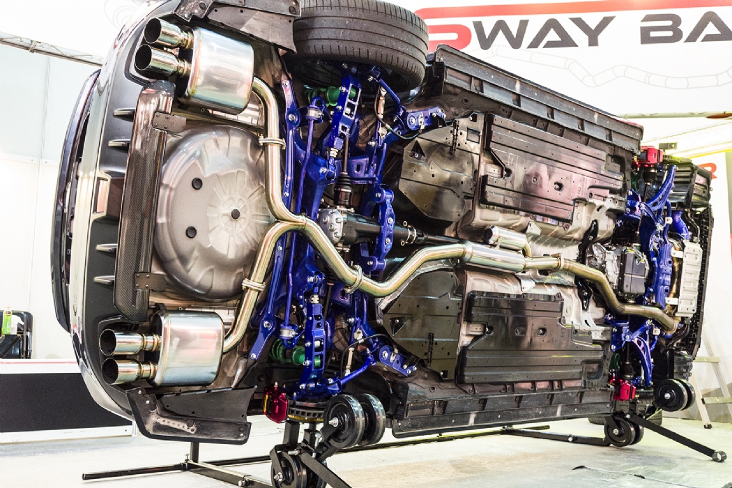

Also found this on the hardrace website a picture of one of their booths.. wtf is that on the mid pipe?? another exhaust!?
