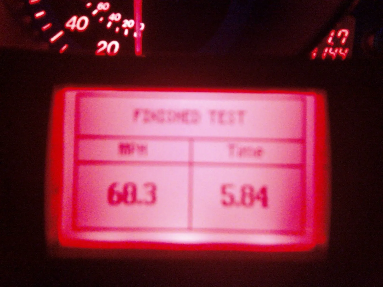

5.84 sec 0-60
I,BPV
I attached a pic for some proof (sorry for the crappy pic from my phone)
I try to do what I call a soft launch. Just enough to hear the tires squeal but not enough to burn them to oblivion.

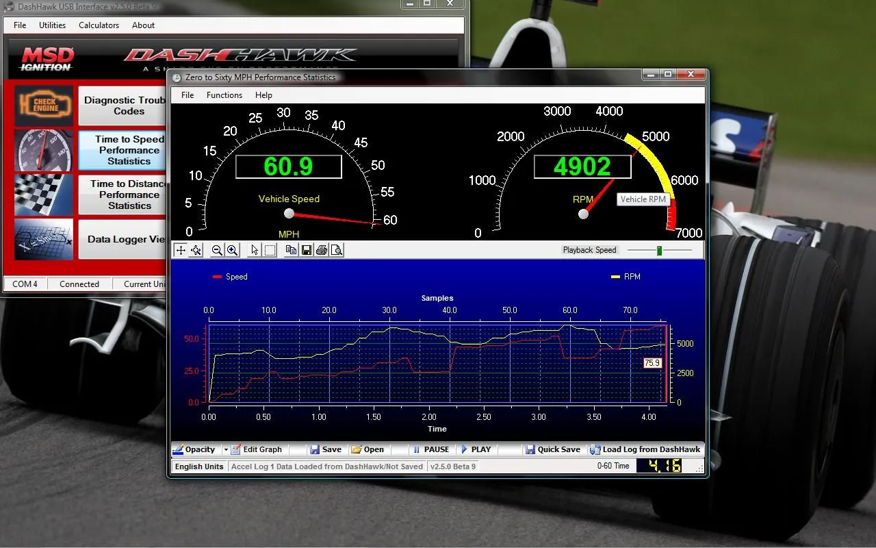

I own a Dashhawk, but have never done a 0-60 run before. How does the DH start the test? Is it from when the tires begin moving or turning? Or, does the DH give you a countdown so you know when you start your run?
Damn, if that's legit reading, you must have been running slicks or something!
i remember someone posting a surprisingly quick 0-60 time a while back from an AP or DH or something, and what happened was when he posted a graph that showed his speed vs time, we realized that the reason the time was so quick was because he spun the tires going into third. that tricked it into thinking that he had hit the 60 mark because the wheels were spinning fast enough to do so, thus his 0-60 time was a good bit quicker on paper than it should have been. according to the chart, he managed to go from about 52 up to 60 in a tenth, which isn't remotely possible with an MS3.
long story short is the AP and DH are pretty cool for following your performance numbers, but just beware they're not always going to be spot on with stuff like this.
edit: thought you were talking about the 5.84s time posted, didn't even see the DH log pic posted below it.

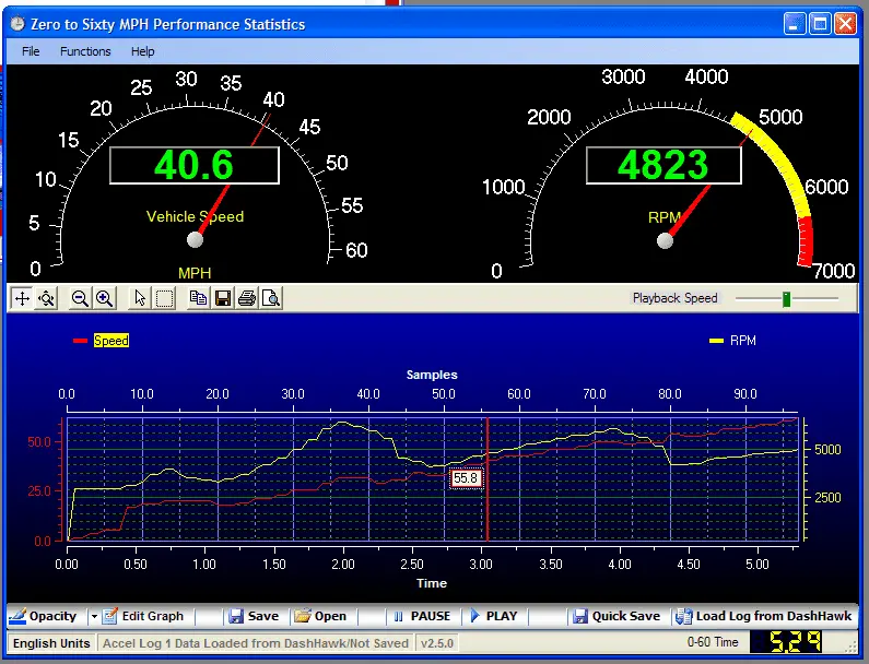

I don't do these too often but I did one just the other day for fun...Had too much wheelspin in first at launch and had to let off the throttle and get back into it, but still pretty decent, for me at least.
motor mounts and good tires sure do help
That's what I thought as well, but then someone brought forth evidence that the speed is monitored at all four wheels, so wheelspin in the front wheels doesn't effect the speedometer.
However I will say that using different logging devices with vehicles in different conditions should only be used for entertainment purposes and in no way should be used as an ePeen measuring tool.
So your stock other than motor mounts and tires? Impressive numbers.

thanks but no definitely not stock lol. The intake/inlet/fmic/turboback/AP/Meth probably helps a little too! biggest issue/challenge is the launch and traction
