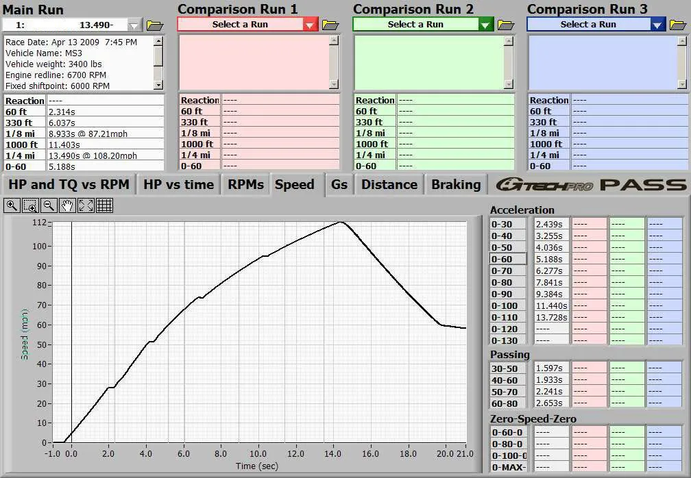

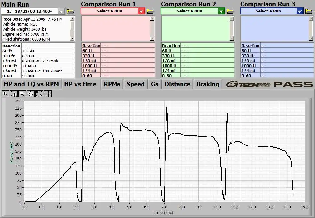

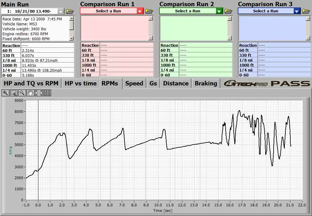

Here is some accelerometer data to consider. Mods listed below. 5.1 seconds is as good under ideal conditions as I can get with my mods.
However, the 4 second WRX would be in a heap of trouble from 60-100 mph, once his launch advantage disappears and we get full boost in third.
Submitted for your consideration:
