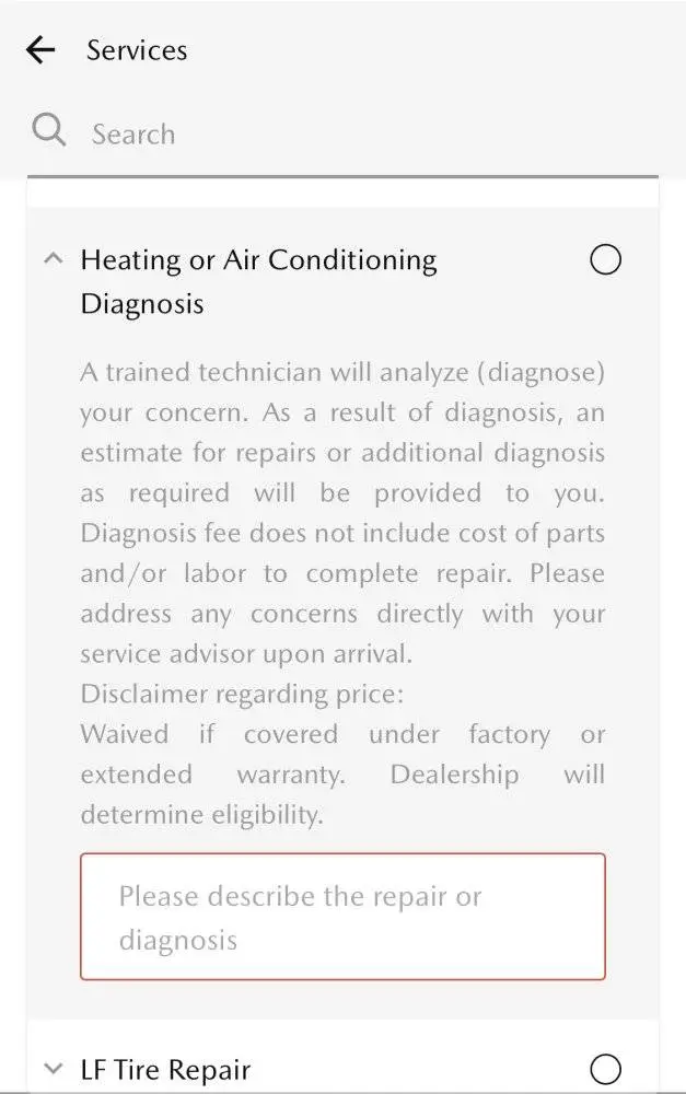

Here is a screenshot of the dealers scheduling system stating that they do indeed charge a diagnostic fee.
What baffles me is, how would I know if my issue falls under warranty. I’ve been burned before by Honda and had to pony up the $150 for diagnostics fee. Who decides if it falls under warranty?
Just curious before I go in and let them charge me to take a look at something that should indeed be covered under warranty.

If your A/C isn't cooling and you did not release the refrigerant or mess around with the A/C component then it will be covered under warranty and you will not have to pay the diagnostic fee.
The fee is more than likely for the people that bring in their vehicle, have the dealer figure out what's wrong with it then leave and either try to fix it on their own or take it to their local mechanic.

“Disclaimer regarding price:
Waved if covered under factory or extended warranty.”
Your problem is covered under factory new car warranty.

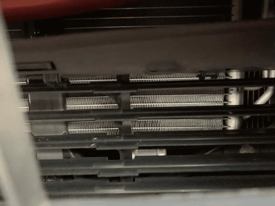

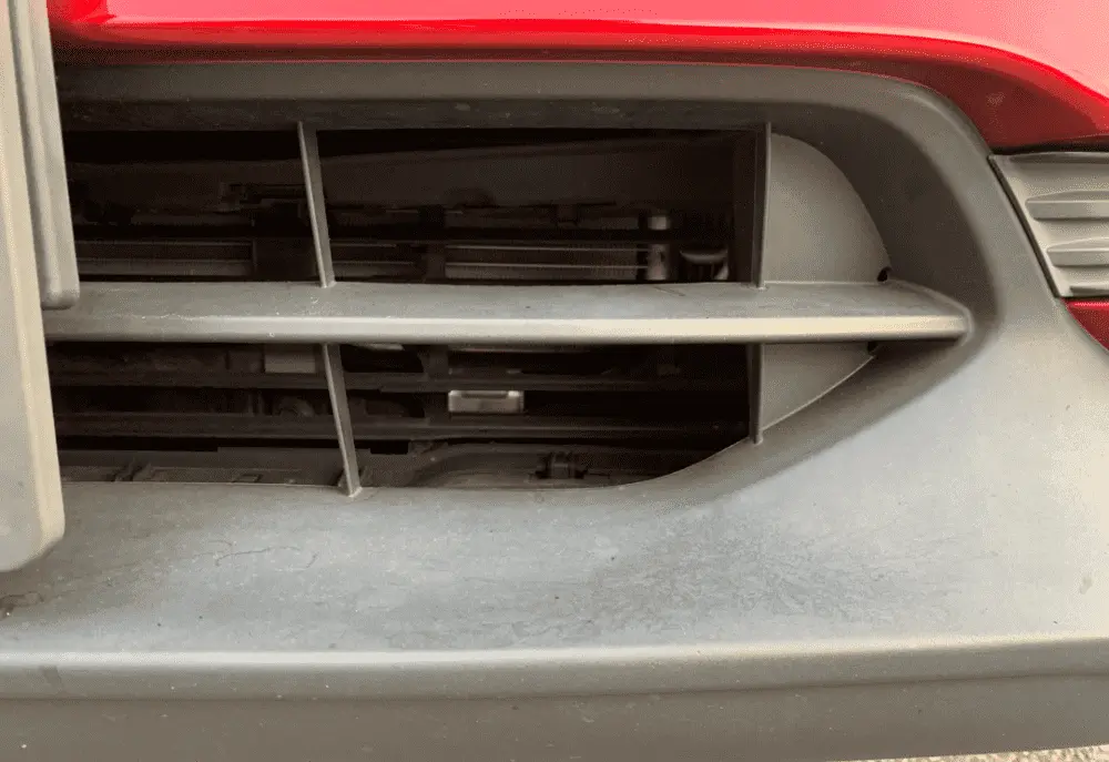

Has anyone else noticed that the CX5 actually has louvres guards protecting the AC Condenser? Here are some photos with the guards 'opened' up. I've noticed that mine has been open or stays open while driving. I haven't been using the AC or the Heat but I do note that this used to be closed or at least when I took it to the dealer, it was fully closed. I've checked during a cold start and after driving around for a bit, it's always open. I'd want to keep it closed to prevent any debris from damaging especially while driving.
Does anyone know why this is stuck open? or when does this close or how it is controlled?
