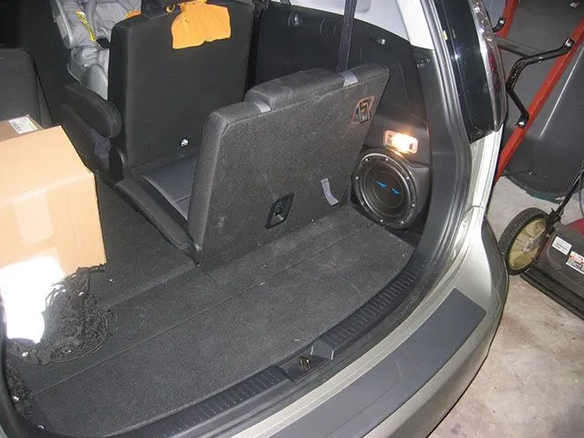

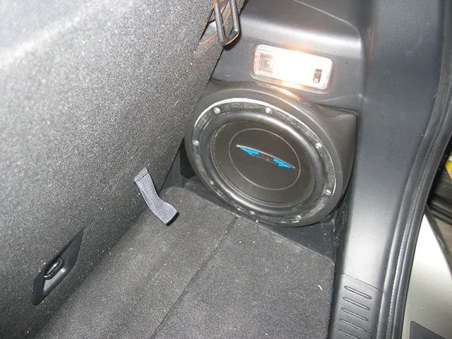

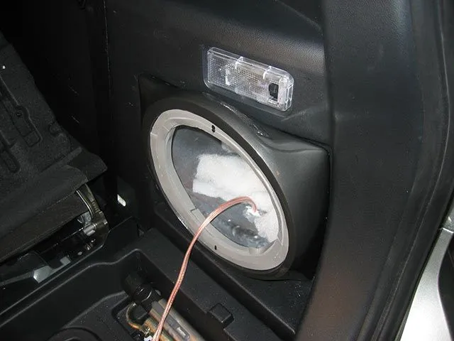

Here are the pics. The final pic with the speaker installed is before I was able to clean up, etc because I wanted to the speaker to sound good first. So, you can see the door strip which is no longer there and I haven't had a chance to paint the screw heads black, etc, etc.
