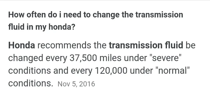

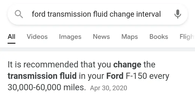

Show me one owners manual where it says you have to do a transmission oil change at 30K miles. I'd love to see it.
Honda is 37,500. That's hard to remember, but 30/60/90 etc. is easy.

Ford is 30,000. I can keep going, but I think you get the point.
