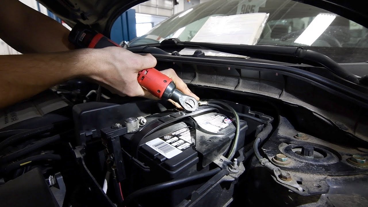

So I've never replaced a battery by myself. Any good youtube clip or tutorial to do it? I will try to get that done this weekend when I stop by Costco.
If you drive to just about any national car parts store, they will test the battery for you while still in the car.
