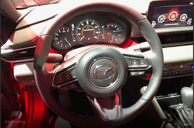

Would be nice if the updated CX-5 got the new 7" TFT dashboard display from the new Mazda 6....
