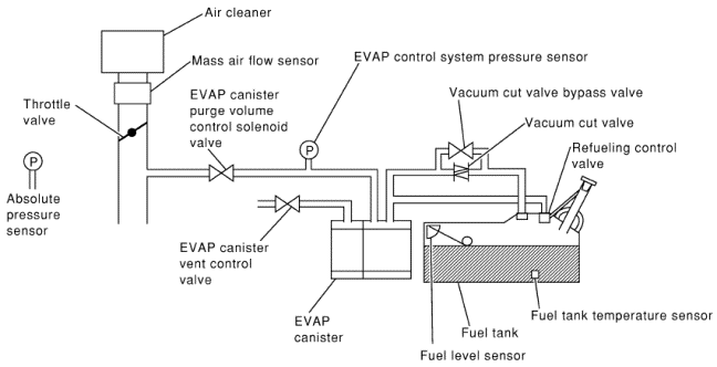

Looking up the P0455 code shows it as a large leak. My understanding is that typically a gas cap leak is a small evap system leak. The code for a small (gas cap) leak is P0442. There is the rest of the system to check (lines, purge valve, etc).

Did you ever figure it out? I have the same p0455 problem and so far I have checked the purge valve (it is working) and replaced the gas cap, but to no avail.
Upvote 0
It's been a while, but yes I did figure it out. After changing the battery I replaced the gas cap with an after market one and the code remained until I replaced it with an original I had to get from the Mazda dealership.
