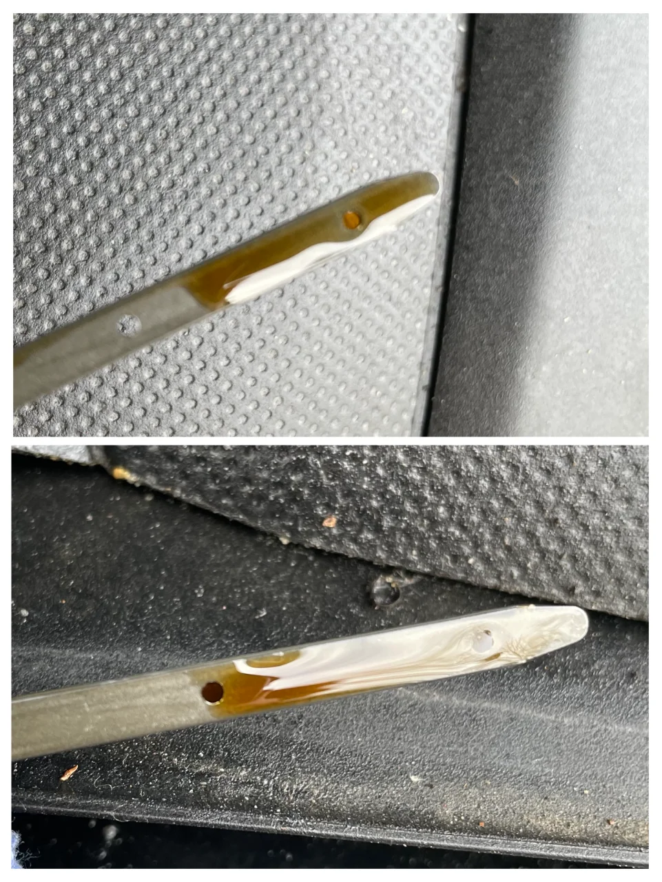

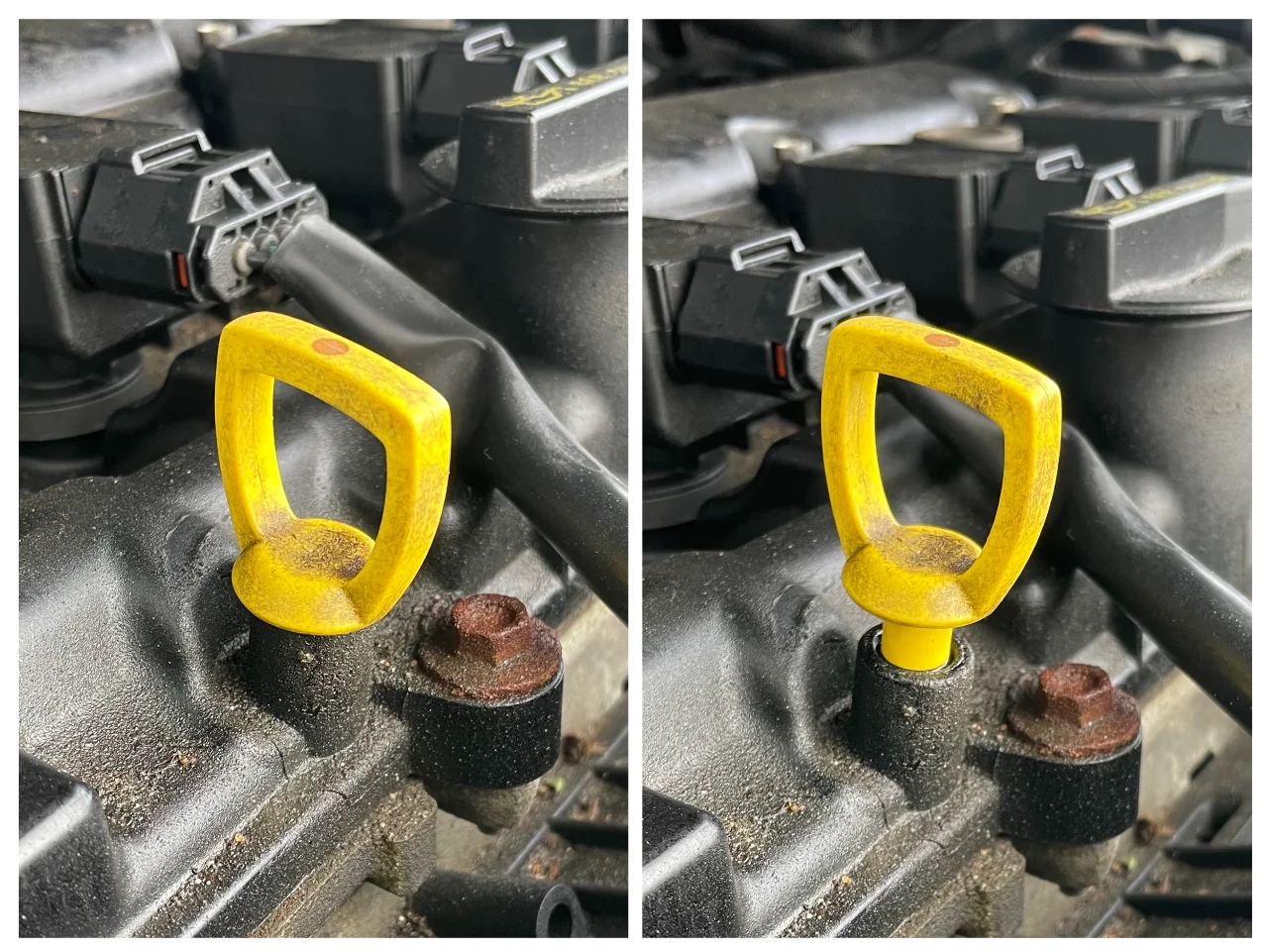

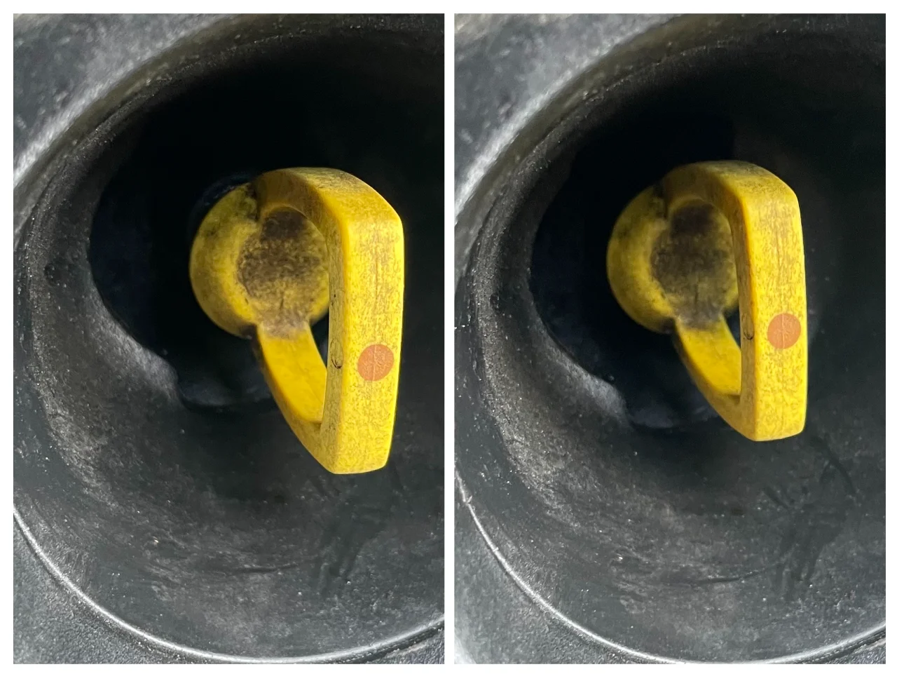

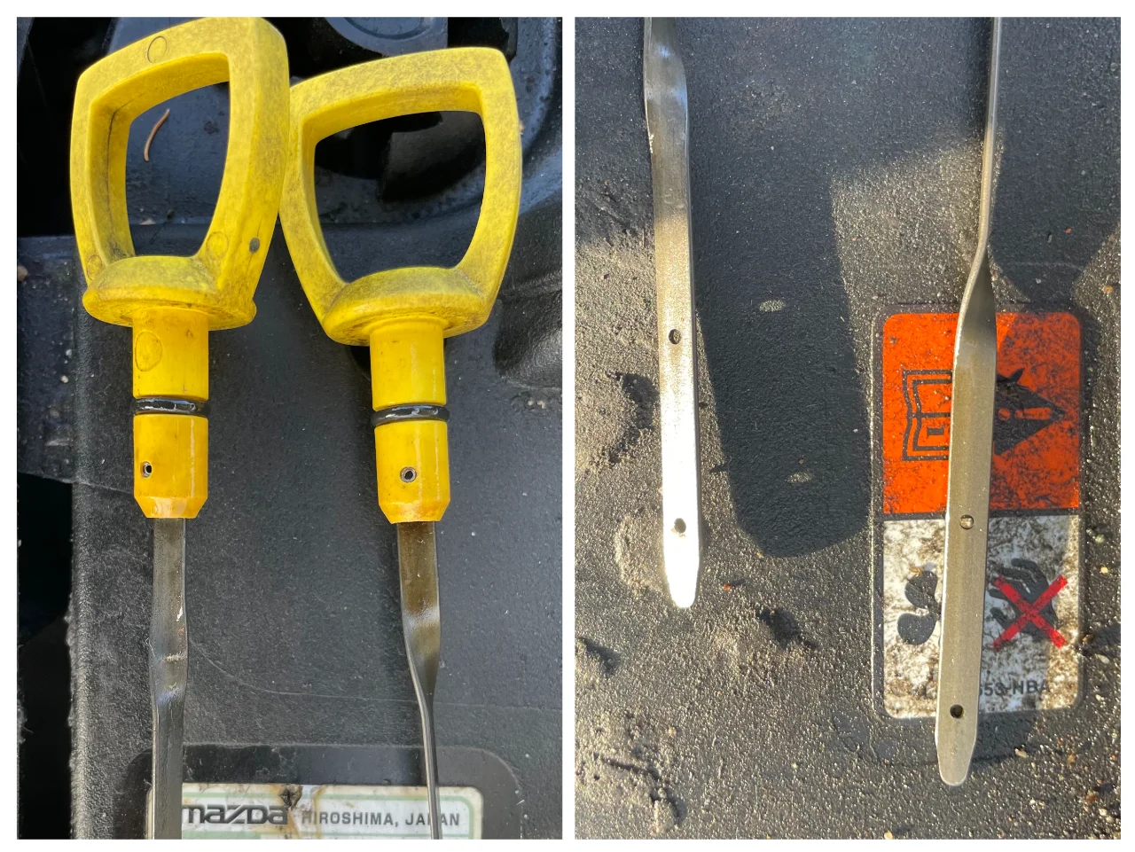

Not really sure it relates to your issue or where to post this but yesterday I was curious whether the dipsticks on my 2.0 sky 3 Sport were, after seeing numerous posts on dipsticks and capacity, the same length as my 2.5 sky CX-5. Turns out they were different and just for the hell of it here’s a picture. More interesting came after I checked the oil in the CX-5. When I inserted the stick I pushed it down and when it, what I thought, bottomed out I hauled it out and checked the oil. It showed ⅓ low between the marks. I thought this was weird since 200 km ago it was full. Again I inserted it until it felt resistance but this time I pushed a little harder and it went past the o-ring to its correct location. This time it was full at the top of the marks. Perhaps it was the cold o-ring and perhaps it was my being cold, -8 degrees C and windy but here are a couple comparison pictures. Strange thing is this is the first time I experienced this on either of the cars. Oil is M1 0w20 with 2500 km on it with 122,000km on the engine and the 4.73 L Jug put it to the top mark back in Oct when it was changed..
