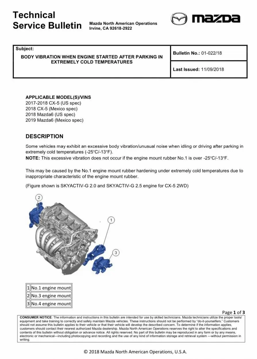

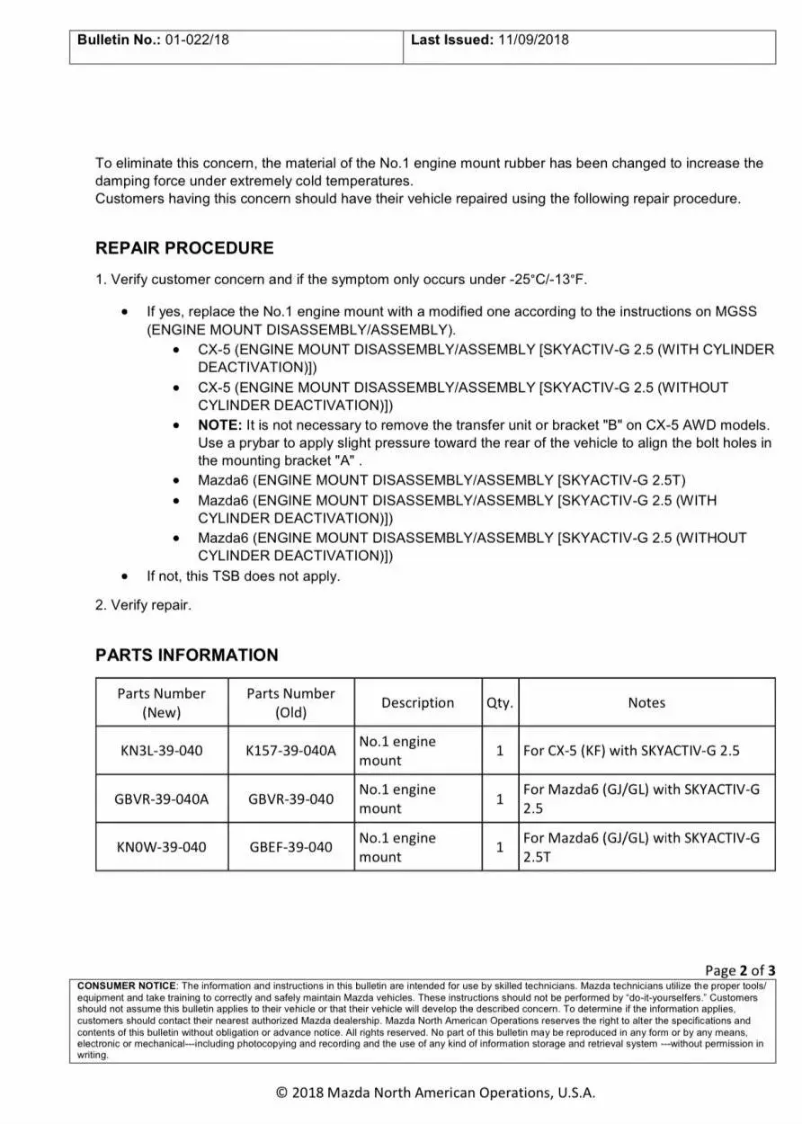

Based on this engine mount TSB, the revised #1 engine mount, KN3L-39-040 which replaces K157-39-040A, is applicable to all gen-2 CX-5’s, including 2017 CX-5 2.5L without cylinder deactivation. Thus having active engine mounts controlled by PCM should not be the case on CX-5.
TSB 01-022/18 - BODY VIBRATION WHEN ENGINE STARTED AFTER PARKING IN EXTREMELY COLD TEMPERATURES
This vibration may be similar to what Honda owners have dealt with for years re: VCM. When cylinder deactivation is added to an engine, a common engineering approach appears to be suppressing vibrations by decreasing the durometer of engine, transmission and rear drive axle shaft and assembly mounts. The down side is that under certain conditions (usually low speed, moderate load and certain ambient temps), the softer mounts let the drivetrain oscillate where it can be felt. I'd bet the PCM update changes engine torque management and 1st lockup behavior.
I haven't looked, but do 2018 and newer use one or more active engine mounts (which could be PCM tweaked)?
