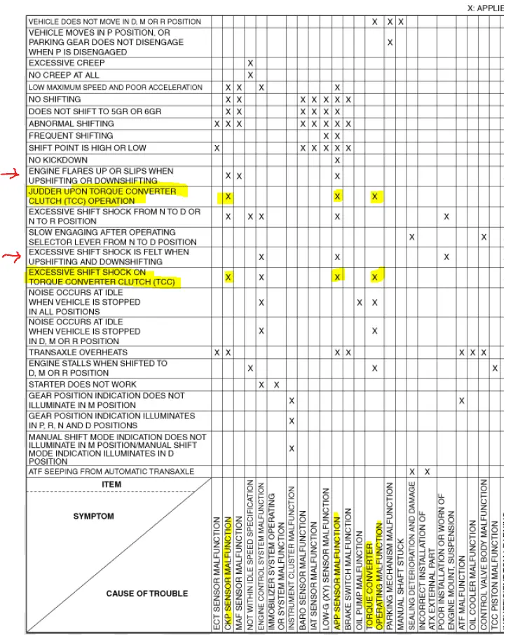

Here's a diagnostic table:
I think there's two issues being discussed in this thread:
1. Engine Flare/Slip or Shift Shock when upshifting or downshifting and when the accelerator pedal is depressed --- marked up with red
2. "Judder/Shift Shock" when the torque converter clutch (TCC) is operated --- highlighted in yellow
Where did that chart come from? If nothing else, perhaps it will help some of us describe the issues we experience with words the dealer should understand. In the past I have always felt that many things were lost in translation between the service advisor and the technician.
