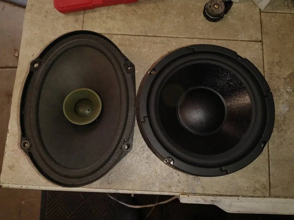

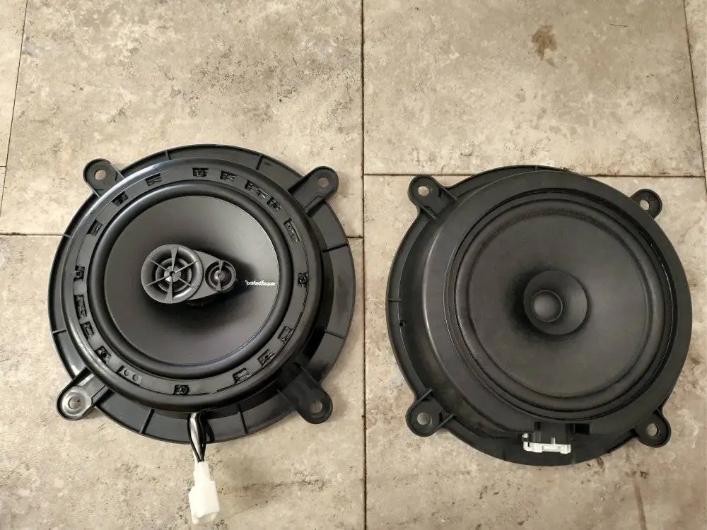

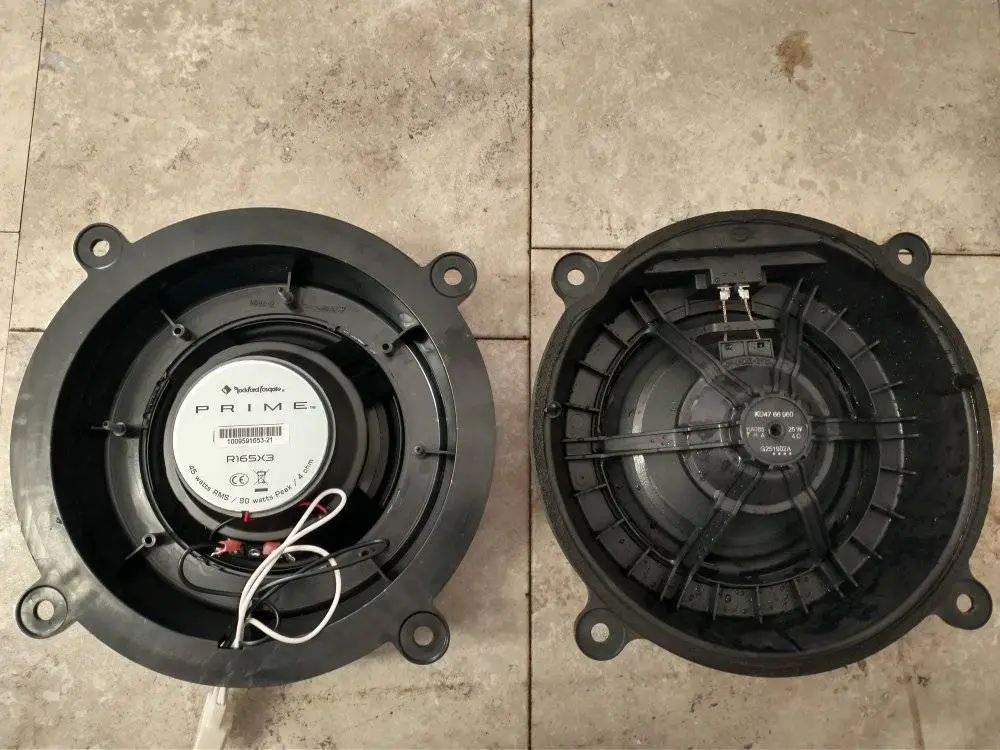

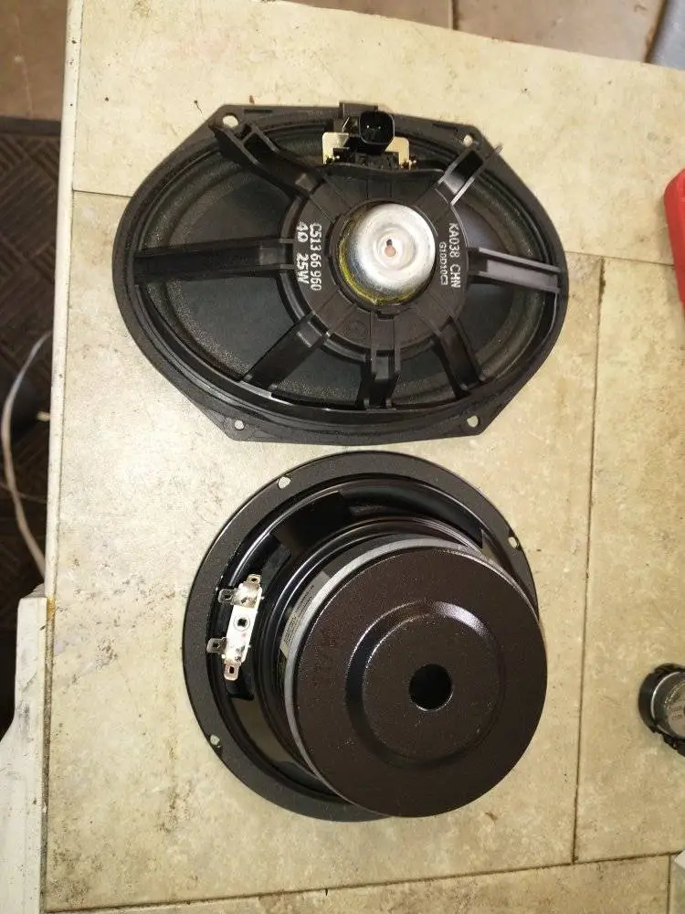

Here are the physical differences in drivers of even modest, and I really do mean modest, upgrades in both my CX-5 and my wife's Mazda5 from factory to aftermarket.

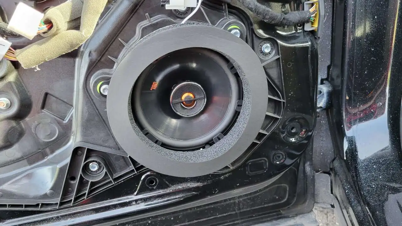

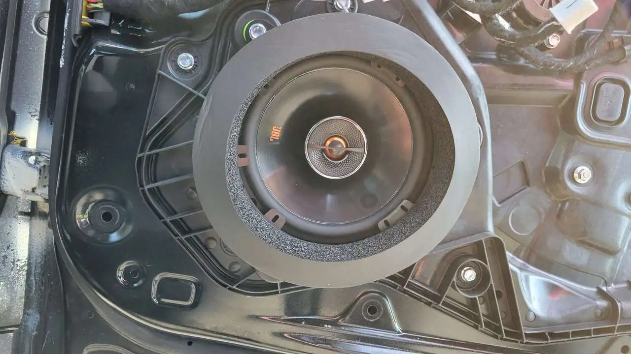

I'm about to put some 6.5 speaker foam rings on the top perimeter of both my new JBL front door speakers. I read that this can help keep all the sound directed into the cabin and not get lost in the door panels. $25 off Amazon, I'll post how it sounds after.
