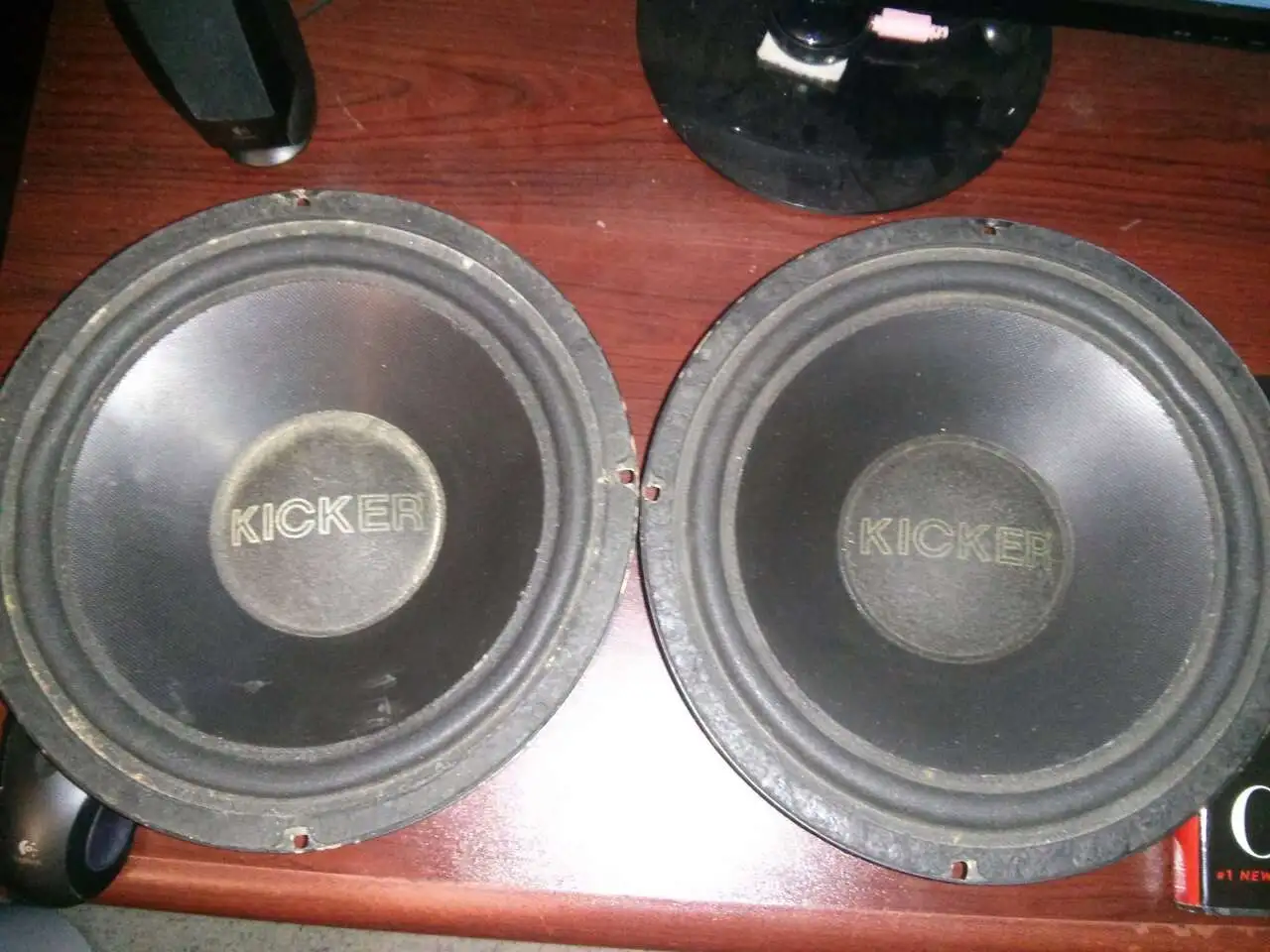

I'd love to see that Alpine equipment. I'm pretty big I to old school stereo stuff. Though it's big time paired down now, I still have a fair few pieces of equipment left. I even have some of the old gold letter Kicker 10's that are still in fantastic shape.
