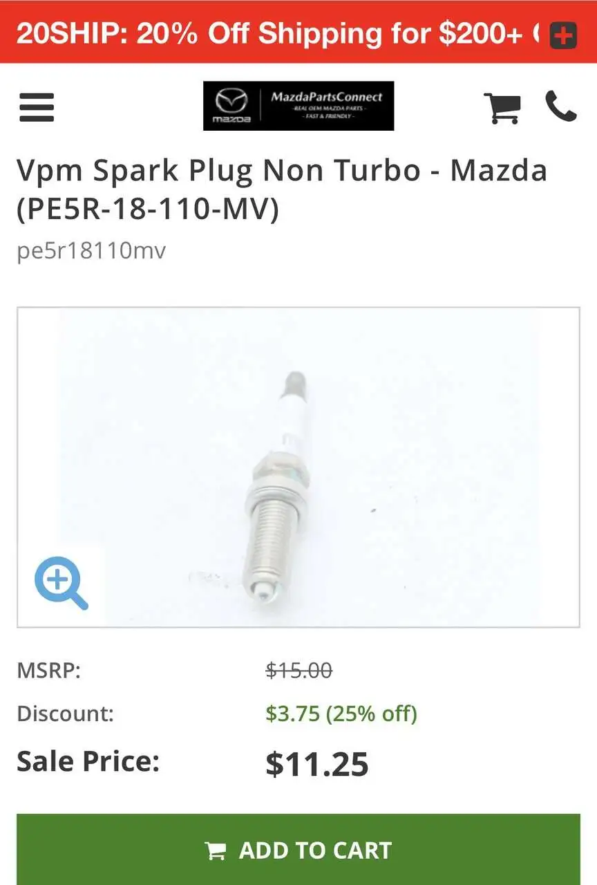

Be aware there’s a Mazda OEM “Value” PE5R-18-110-MV spark plug which is cheaper than aftermarket NGK plug and it’s only ⅓ of the price of normal OEM PE5R-18-110 plug.

What's wrong with the Value Line plug. Looks like its from NGK, what do they do to make it cheaper to manufacture?
The notion of value line is a big turn-off, especially with no information about the differences.

The real question is what makes the Mazda branded plug so expensive?

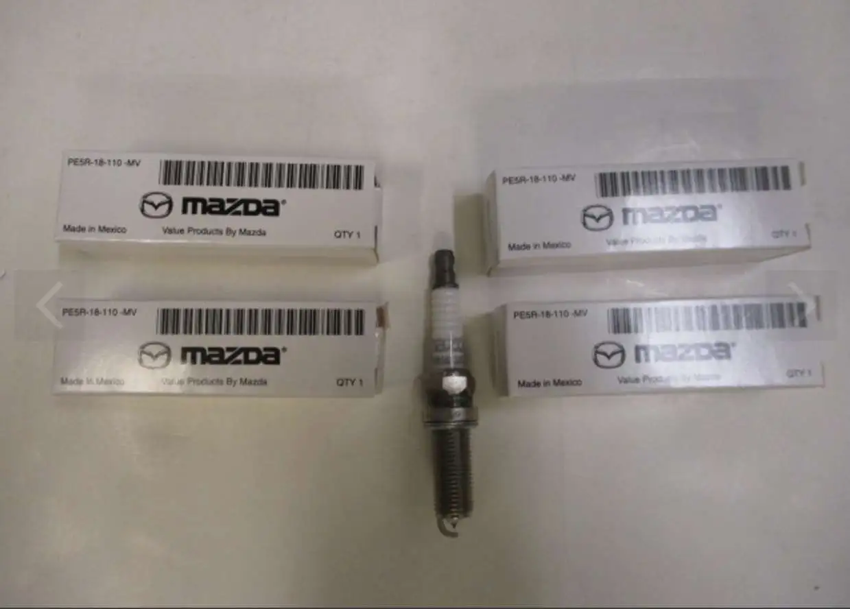

The PE5R-18-110-MV spark plug doesn’t have “NGK” imprint on the ceramic insulator. Nothing said on the box it’s from NGK. It’s made in Mexico and I don’t believe there’s an NGK spark plug sold in the US is from Mexico. It’s much cheaper for sure and it’s backed by Mazda ⋯ :unsure: :whistle:

I assume there are no horror stories with those plugs, just not trusted like NGK?
I remember one instance of a member having misfiring issues shortly after a plug swap, and the issues went away after switching to either an OEM plug or a branded plug. Unfortunately I can't remember whether the first plugs they swapped in were MV plugs or some other aftermarkets.
EDIT: Here's the thread. Looks like OP swapped to NGK ILKAR7L11 plugs, same ones that many others have used without issues, BUT in his case they may have been counterfeit plugs. It was never verified/confirmed. After he bought the Mazda OEM plugs, his issues went away.
I personally will be swapping to my last set of NGK "equivalents" for my 2.5T sometime this weekend. After that I'll probably give the MV plugs a try.
Been there :) had horrible misfires on turbo DI (not Mazda) turned out the ceramic had micro crack. The plugs were supposed to be a brand but they had a defect.
Since then no compromise with plugs for me. Given the fact they last at least 40,000 miles and are one of the critical components in the ignition system.
But may be the MV is ok.. I dont know.

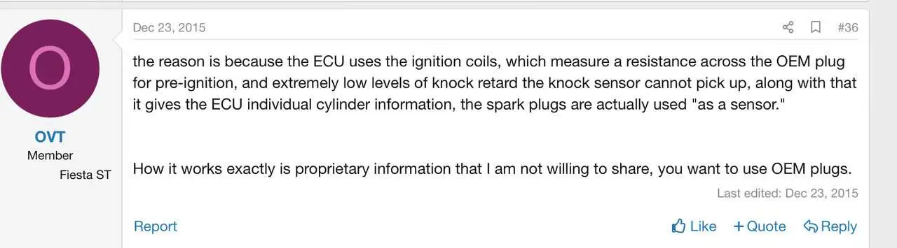

Seems like counterfeit plugs have resistance values all over the place. I plan on buying NGK equivalent and just measure resistance before installation to ensure they are in spec.

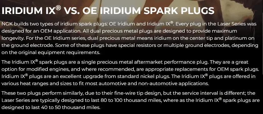

I guess the resistance is for radio suppression. NGK has a bit of information on their plugs recommended for CX5. I wonder if the MV could be a fine-wire platinum plug?
They say the Iridium IX plug is for performance, but has a shorter life. The ground electrode tip is ground to a taper on the IX.
I don't plan on replacing my plugs for a while because these have such a long life. I don't want to replace them with something inferior when the plugs I have work fine. I might consider getting the Ruthenium as they claim better performance and especially long life but I imagine another set of OE plugs will last the remaining life of my car.
