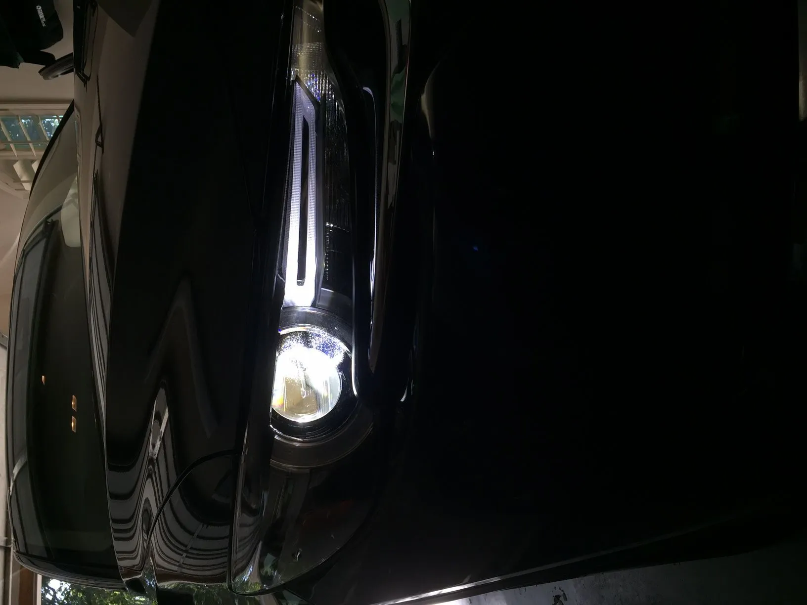

Maybe I didn't word it right. The headlights come on when in a garage when you start moving. The headlights stay on when leaving the garage, but the green indicator will go off. The headlights stay on when you come back to the garage, and the green indicator comes back on. The light intensity of the headlights never changes. Basically, no matter what, if you are moving your headlights are on at full intensity day or night.

So I decided to watch a few videos. I Must say, all front lights except the fogs seem to be on when in motion. And all close ups of the headlight showing just the drl have just the parking light illuminated along side. Those appear to be shots of a stationary car.

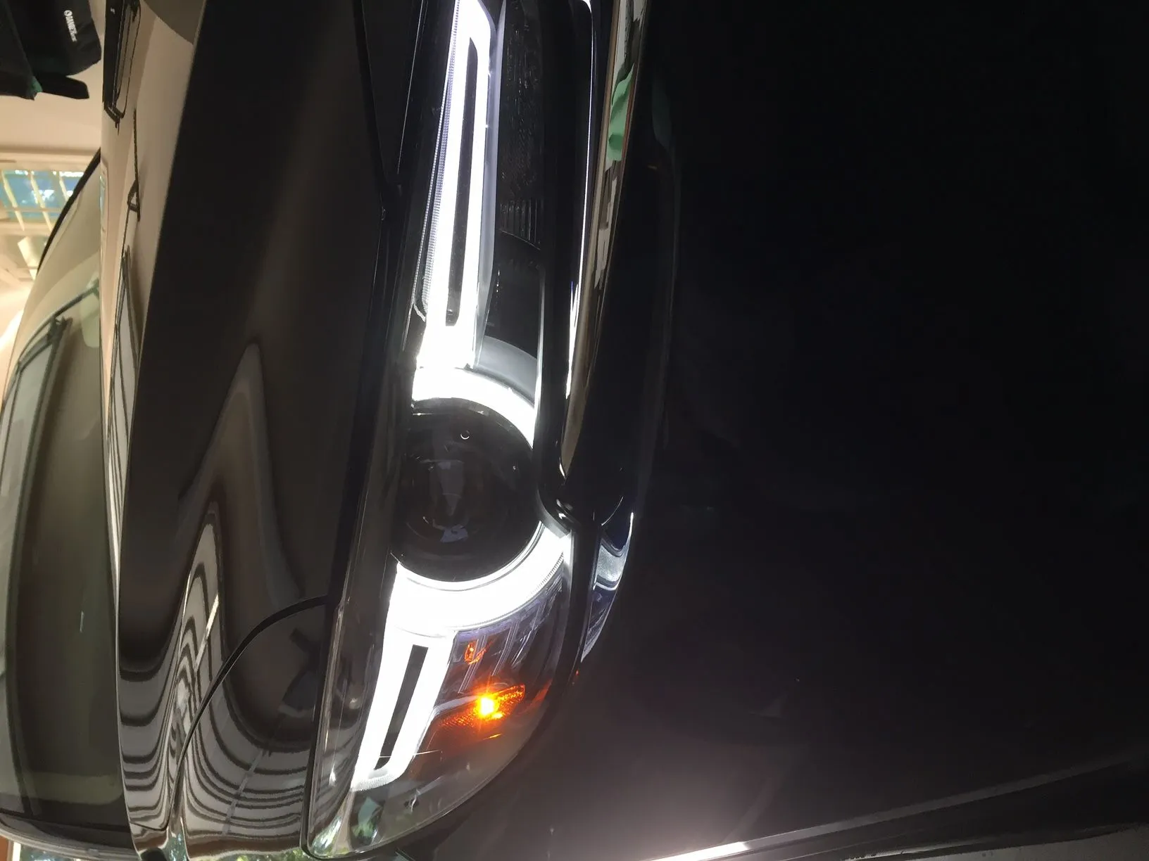

Correct. Only way to get this picture is with the car parked. So are these the DRL's, or are the headlights the DRL's? And if you disable the DRL's, which one do you lose?

What setting is the light stalk on for this picture?
Because it looks like these are your parkers due to your yellow side lights on.
That is taken with just parking lights on and car in park. If I were to drive off, the headlights would come on.
All lights will come on even on parking lights setting? That's not right.
attachment.php
Since these GT Signature LED DRLs also serve as parking lights, they will be on along with front amber parking lights (same dual-filament 7444NA bulb as front turn signal according to Owner's Manual although we cant't see this in picture) and amber side-markers when the headlight switch at parking light (after Auto) and headlight position. I do believe US version 2017 CX-5 wired low-beam LED headlights with Signature LED DRLs together as the DRL, base on reports from 2017 owners here, hence if you change the vehicle DRL function setting to off (has to be done by Mazda dealer), you'll lose both Signature LED DRLs and low-beam LED headlights serving as DRL but those Signature LED DRLs still will be on when parking lights and headlights are on.
