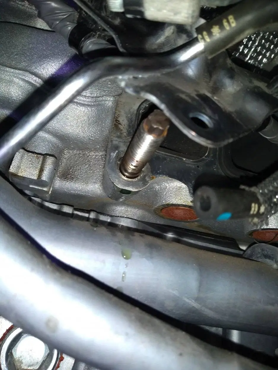

I have a 2016 with 110,000 miles and it did the same thing, decided to do a tear down. I found the issue at least on mine is not a head gasket issue, it's the lower left side stud on the variable valve between the turbo and the engine block. Found no crack on it, there is a cooling pass built in this area, ordered new stud, should be back on the road next weekend.
I'm not very familiar with this part of the engine. What's involved to access this?
Between the turbo and the exhaust ports there is a flapper valve you have to remove the exhaust and the turbo to get to the leaking stud and re seal it there is a cooling passage behind it.
So you're thinking that the stud itself is somehow causing the leak? I'm no mechanic by any stretch, but I don't understand how that could be. That stud goes directly into a portion of the engine where it's exposed to coolant? And something happened to that stud that now allows coolant to leak? I hope you're right.
Someone else did theorize that the bolts have something to do with it, which makes some sense. Perhaps there's a crack deep inside and the crack runs along the threads of where that stud fits into?
I thought he meant the stud was cracked?
