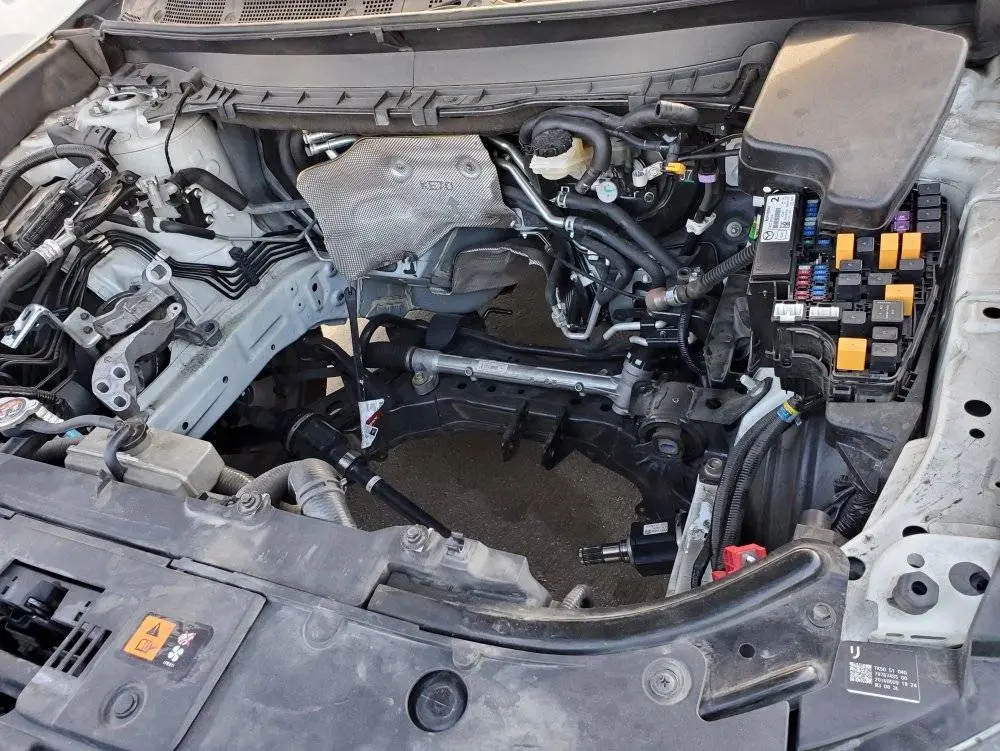

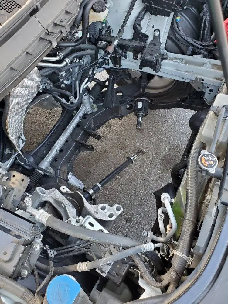

In case anyone is wondering how CX-9 looks like without its engine & trans.
