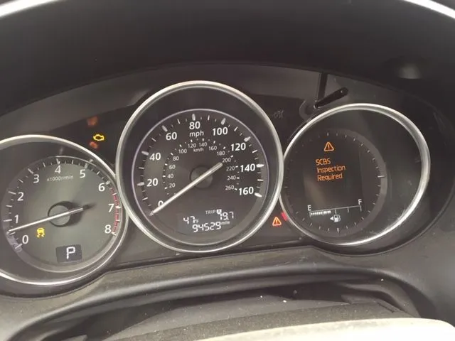

There have been 5 times now in the last 30 days where the car goes through a weird electrical issue. At first, the car would have trouble starting where it would lose all power immediately upon attempting to start. I would have to wait about a minute then all power would come back and I could start the car up.
Now, on three occasions while driving, the car will suddenly lose its power, the dash and infotainment will go through a boot cycle, power steering is lost, and all warning lights come onto the dash with the check engine light staying on for about a minute until everything returns to normal.
The battery is new and I have checked the battery connections and all is fine there.
The picture below is what appeared on my dash from today as it stalled out while driving. In today's instance, the power steering went out but there was just enough acceleration power to allow me to drift about 3 mph into a parking spot, where the dash displayed TPMS Inspection, then SCBS Inspection, then Check Engine
Does anyone know where to begin in resolving this issue?
Thank you

So I ran the OBDII and error code: P0882 TCM Power Input Signal Low
Its now at the shop while they diagnose. Was told it could be a transmission oil issue or a transmission assembly issue.
Will keep you all posted
Well, you guys nailed it!
The mechanic traced the TCM issue back through to a loose connection on the negative battery terminal, just as you all suspected.
Thank you for the advice! +1 for you all!
