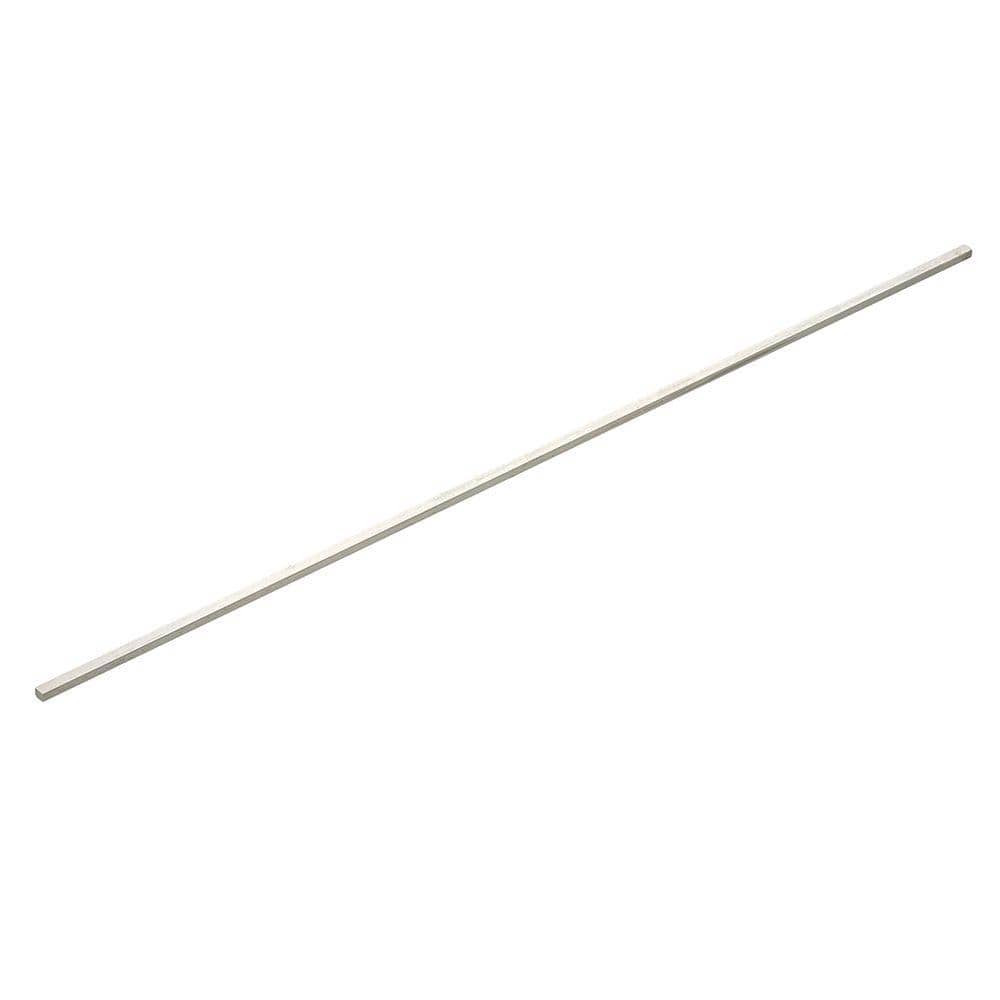

The solid shaft sold on Amazon for $25 is a ripoff. At Home Depot, you can get 1/8" square key stock 12 inches long for $2 - enough to make 6 shafts.
As I mentioned above, I think the solid shaft is a bad idea. If the seat jams, then the shaft will not break and something more expensive will fail, like the motor or the gear drive.
