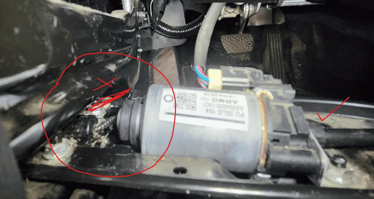

So after looking into it further, I realized the issue I have is not the broken cable, but the motor seems to be mis-aligned on one side. See attached picture. You can see its been lifted up on the left side, the motor and the rotor are visibly far away from each other instead of being in one line. I dont know how that happened, but that seems to have caused the issue. The cable doesnt spin at all on the left side, so I dont know if the motor is blown on one side, or if its the cable that is damaged because of this. I tried to push the motor back into place, but its very hard to do that. I even used a lever to push it down, but its very hard and stuck with the left side a little bit up.
Any ideas how I could resolve this?
I've got the same thing. My motor was higher then it should be. I've lowered it by hands)

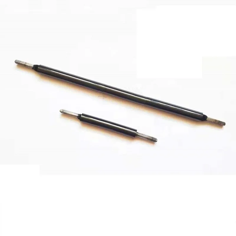

Hey guys. The short cable/shaft is available on AliExpress.
I've just ordered it, hope it will fit. Ordered 50mm.

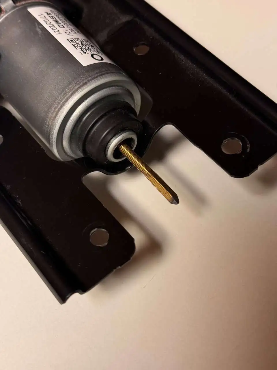

Update: I found a perfect flexible short (50 mm) shaft for $9 including shipping from China on AliExpress. It took only 11 days from order to delivery. See photo below.
The solid shaft sold on Amazon for $25 is a ripoff. At Home Depot, you can get 1/8" square key stock 12 inches long for $2 - enough to make 6 shafts.
