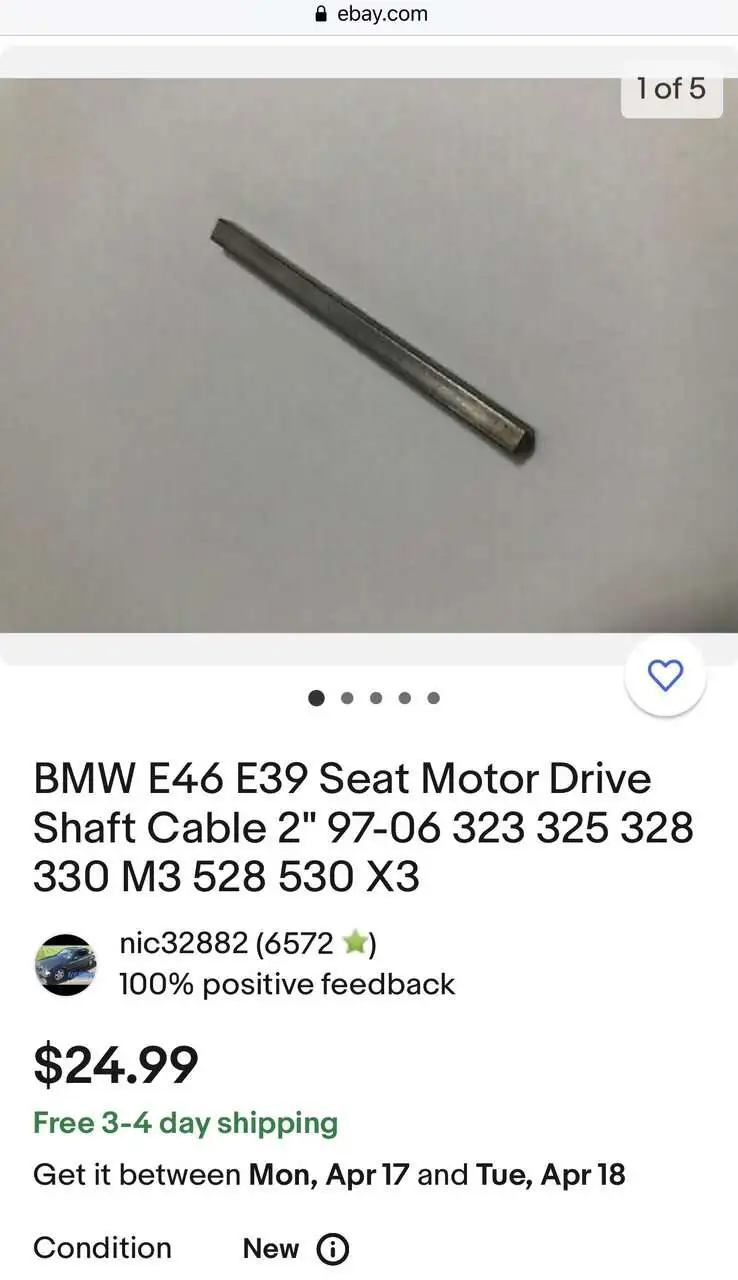

I decided to take a gamble and order the same BMW part for my Mazda6 when I had the same issue described above (left side of power seat would not move, right side would). Dealership quoted me at $1500 to replace "the whole bottom portion of the seat."
Decided to order the $12 part and took it to a local shop for the repair while I was at work. They fixed it within an hour for $100 or so.
Thanks for the discussion & advice!
These cables / drive shafts are currently still available from eBay. Of course $12 shipped for the replacement cable / drive shaft a few years ago now is $25! The replacement is a solid stainless rod instead of a speedometer cable type that should last forever.

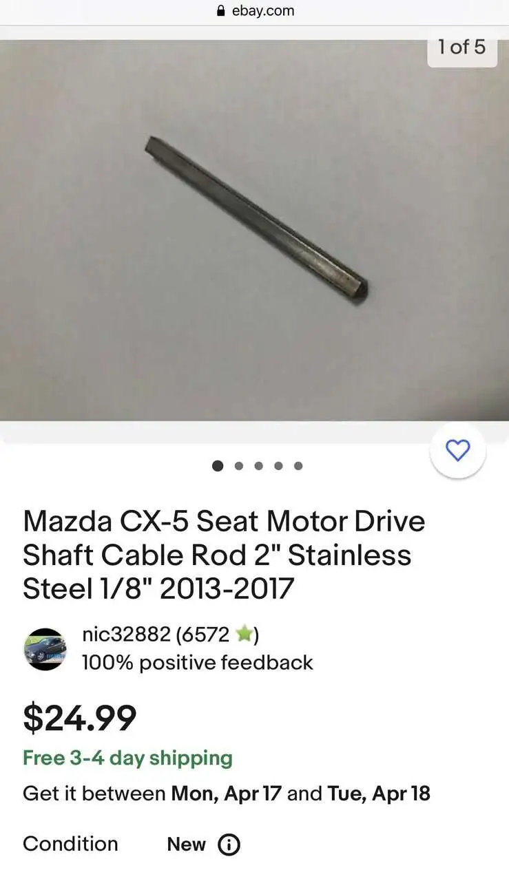

The correct part is "Mazda CX-5 Seat Motor Drive Shaft Cable Rod 2" Stainless Steel 1/8" 2013-2017" (look it up online)

Getting a short motor cable / shaft from eBay ($25) to fix the power-seat problem OP had definitely is much much cheaper than getting the whole seat base ($1,000? $1,500?) from Mazda dealer.
That little piece of eBay power seat motor cable / shaft made in China used to be $12 with shipping just a few years ago now it’s $25, thanks partially to imposed higher tariffs against China by US government.

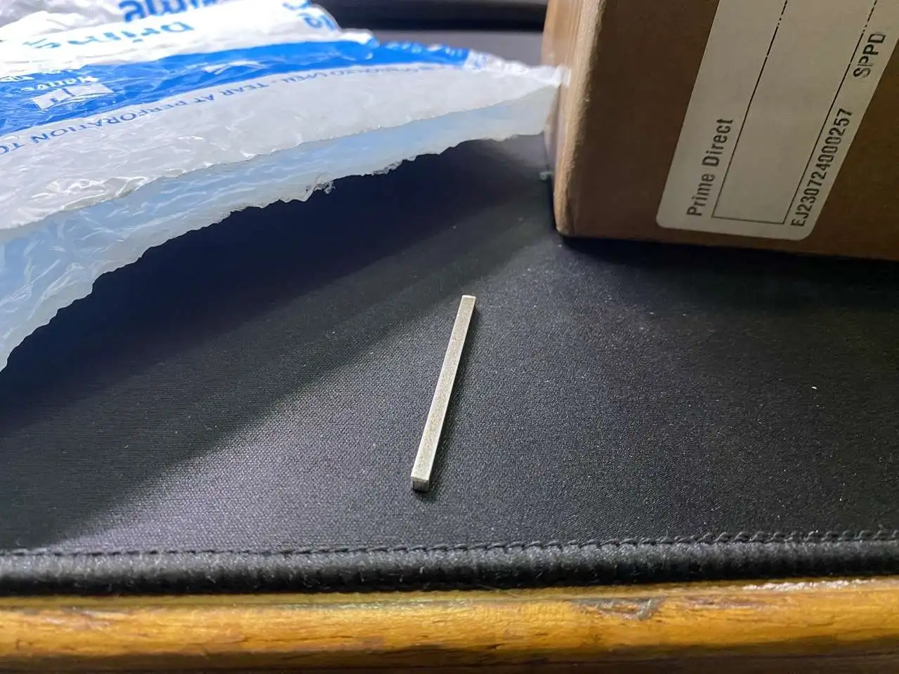

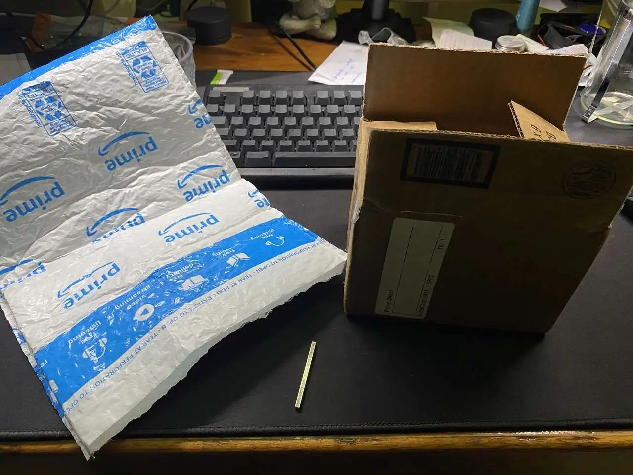

I can't believe I paid $25 + shipping just for this tiny piece of metal.
This eBay stainless steel replacement seat motor drive shaft cable rod was selling $12 shipped just a couple of years ago. $25 plus shipping is still much better than getting the whole seat base from Mazda for $1,000!

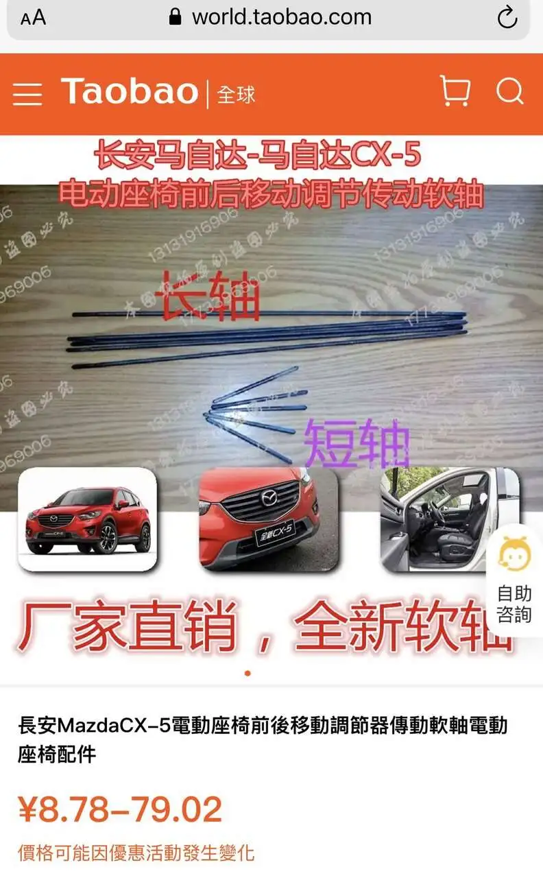

Of course you can always blame it on those “greedy” Amazon / eBay sellers, as you really can get the same part in China for ¥8.78 CNY which is about $1.23 USD!
When those eBay / Amazon sellers import a box of CX-5’s power seat motor short cables from China for business, they usually have to pay import duty and it’s 20% ~ 30% higher now. That with high inflation contributes current $25 price for this power seat repair part which used to be selling for $12 not long ago. Still I appreciate those Chinese manufactures who give us a much better alternative with a generic repair part to fix our power seat problem.
