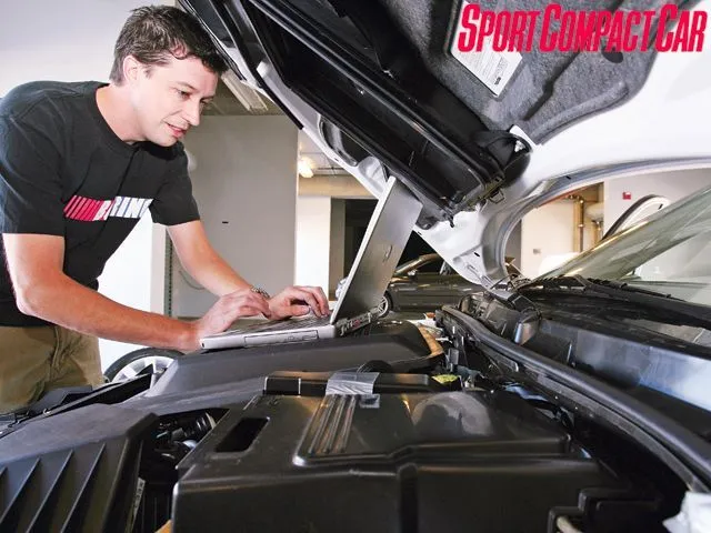

Gen 1 ram air intercooler scoop attached. Look up at the bottom side of the hood.
the area where the old gen used the ram air for the intercooler, the new one uses that area to feed the intake while the scope is used to feed the intercooler.
Show me, please. I'm skeptical. For me, it does not matter, since I run a true CAI. But for many this would be important. True cold air to the intake air box? Pix please.
+1 - I want to see this myself.
