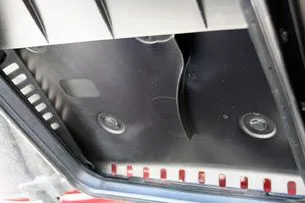

I do question the benefit/detriment decision making of Mazda to put those slots in the underhood part of the hood scoop, compared to the completely sealed previous design. This does allow some outside air to get into the engine bay where the airbox or an aftermarket intake could maybe get some cooler air. That would be a good thing. It also would allow some means for heat in the engine bay to have a way for some modest escape route, also a good thing. That would both tend to favor an advantage in performance --- maybe. But this is at the expense of heating up the air that is hitting the intercooler coils and thereby reducing intercooler effeciency. Those slots are actually pretty big.
See attached pix. Sorry for the low-res. Best I could find, but shows those slots in each side, too, not just in the back.
To what extent this tradeoff is an overall benefit or detriment, is unknown. Since both the gen 1 sealed ram air and the gen 2 external scoop appear to work very well, this may just be nothing more than an interesting academic exercise.
I bet the hood scoop ran into a problem of having too much flow, more than could pass through the TMIC. They had to give the excess air some place to flow so that there wasn't a huge build-up of pressure in the scoop. The ex-flow from the TMIC would be severely limited because of it's proximity to the engine block I would imagine.
Would that be the same reason that gen 1 sealed ram air to the TMIC has an "overflow" conduit over to the general area of the top of the battery box, just behind the stock airbox?
Makes sense to me. The pressure is acting over a very large area, so even 1-2PSI of pressure build-up could apply over a hundred pounds of force to the hood (1ft^2 @ 1psi = 144lbs of force) which is like an average-sized dude standing on the direct center of your hood. And I'm pretty sure the duct has a foot-print larger than 1sq foot.
The engineers probably designed the venting systems for the pressures and flows generated at 155mph as the worst-case scenario. They probably chose to sacrifice a little bit of performance at lower, saner speeds, for the potential problem of your hood ripping off at 155mph.
Just my educated guess though.
