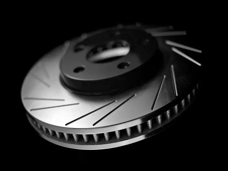

FWIW, I've been looking for an upgrade without going too overkill and getting a BBK (although the one from Cork Sport is reasonably priced).
What I ended up ordering was this G4000 double slotted rotor running Z23 pads. I'll let the group know how it goes in a month or so...waiting on the rotors now.

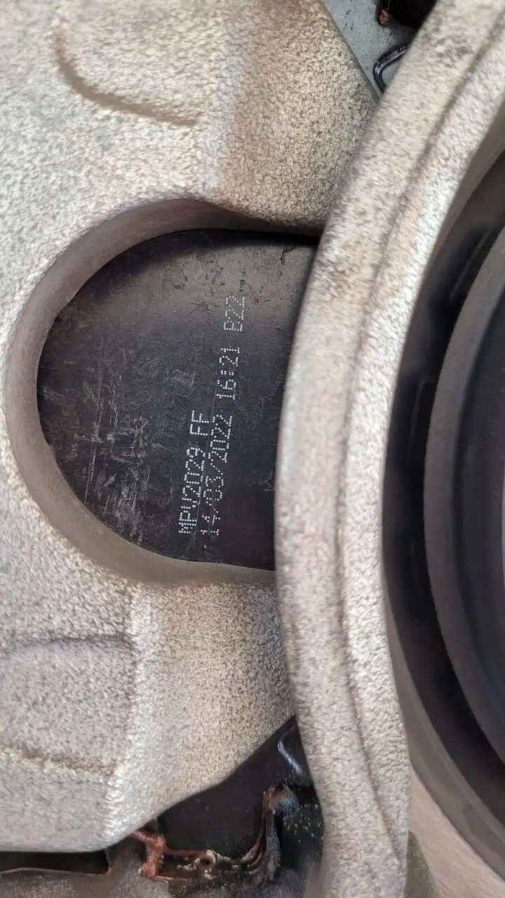

I just posted in the forum with grinding noise while braking on new OEM brake/rotors. I tired the several hard stop from higher speed method and after a while the noise went away but then came back the next day.
see this link for complete story: Grinding noise on new OEM brake/rotors (2018 CX-5)
Any other suggestions?
So, the hard stops to put heat into the brakes suggestion for that OP was for a several year old car with very low miles. Reading the details of what you are experiencing is different with new pads and rotors.
I'll respond more thoughts in that thread.
I took it to a second opinion shop and they hear the noise but cannot find what is wrong. They said it may be cheap brake pads because they tried to Google the serial number on the pad and cannot find anything on it. Can someone verify if these are the same OEM pads they have on their cx-5 by the serial number. Thank you so much.
