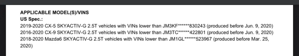

Fyi If there was any coolant that made it's way Into the engine oil, then per tsb the engine is to be replaced, not just the head. Make sure the dealer is doing this.

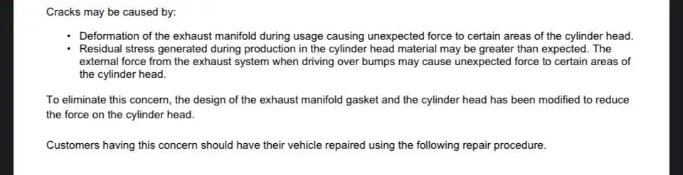

The TSB applies to every CX-9 made before June 2020. It's a design flaw.
The way I read it is Mazda added a turbo to an engine head that wasn’t designed for the additional stress it caused.
