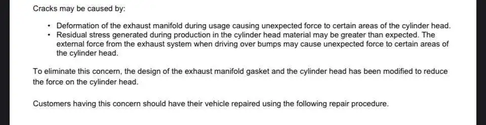

The way I read it is Mazda added a turbo to an engine head that wasn’t designed for the additional stress it caused.

No it's more both a design flaw and manufacturing problem.
Added stress from a Turbo wouldn't explain the NA cracked cylinder heads. Design was weak from the start for a high pressure engine coupled with possibly overtorqued bolts at factory.

The head problem/coolant leaks seem to be happening on both
CX-5 and CX-9 turbos and non turbos...didn't realize which thread this was. And for it to happen across both lines and engines means the something in the design was flawed from start, regardless of which model or engine.

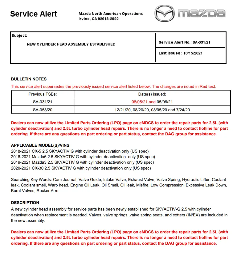

I've never heard of this problem on the NA engines. Where have you heard this?
There were reports of the 2.5 NA with cylinder deactivation having a cracked head. The regular 2.5NA is solid though.

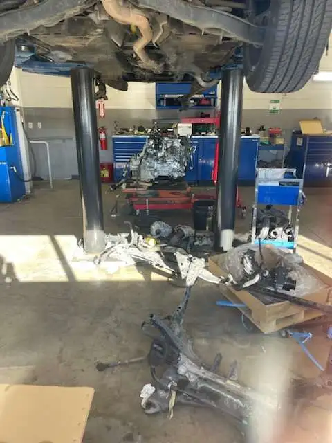

Follow up to the issues I had after a new cylinder head installation. The dealer took a look at our car and found a hose clamp that was not seated correctly. Not sure why it didn't leak immediately but this was our first "longer" drive after the cylinder head was replaced. Dealer replaced the hose clamp for free and all has been good for the past few weeks.
At this point, I'm looking for puddles and sniffing like a hound hoping to find the issue. Better now, since with a new engine I'd be good to go. If this happens instead on a trip, a few months out of warranty...

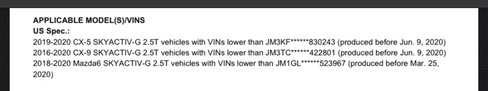

It looks like Mazda sold about 120k CX-9s during the 5 year period the TSB references. Doing some back of the envelope math, the average dealer would have sold slightly less than 1 per week. If they are repairing 1 a week, that's not a good sign... You said they had 3 in for this work?
