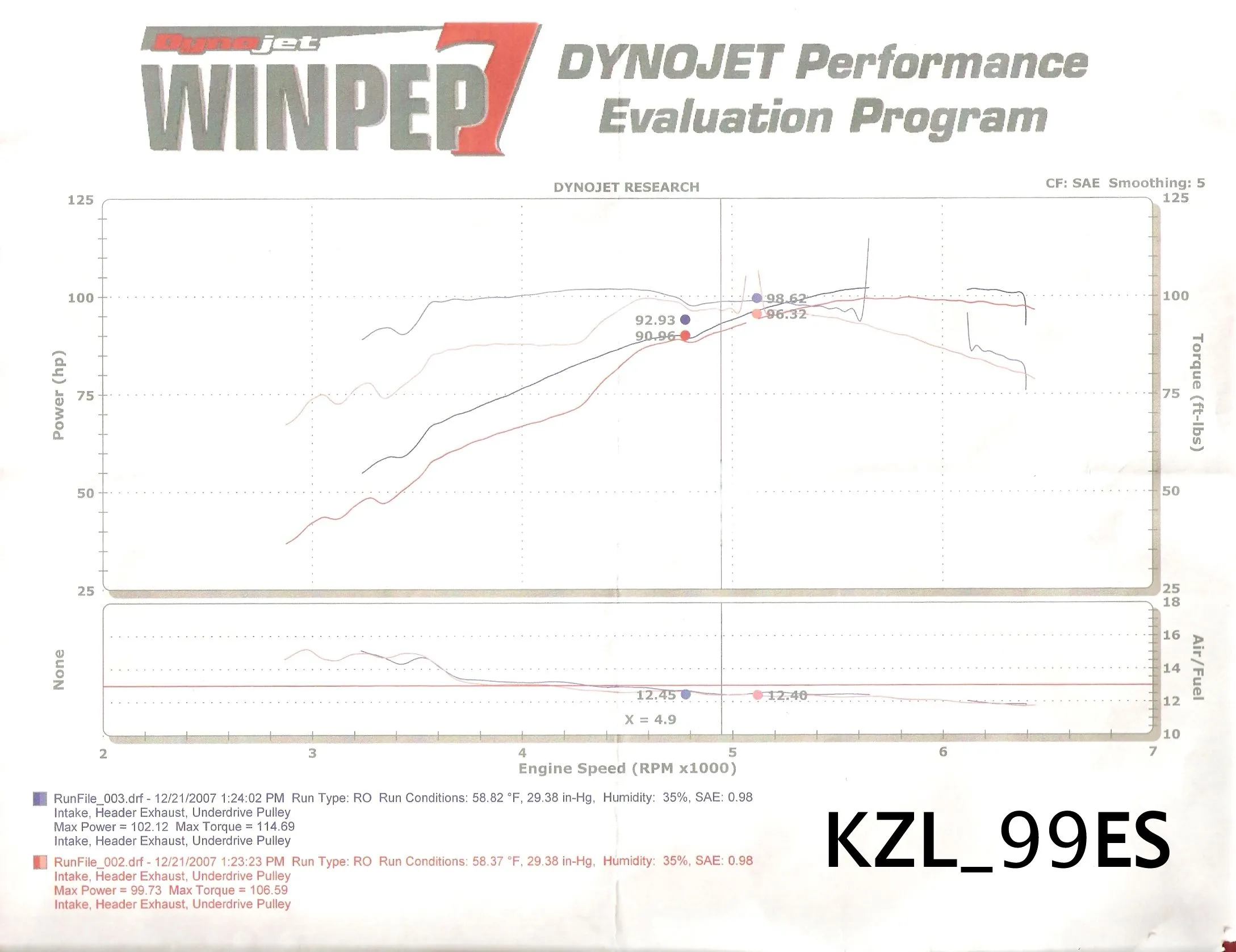

this is my dyno from Speedquest Inc., i'm not sure if the numbers are any good since i have nothing to compare them too...if someone could give me a conversion for hp to whp or a dyno of a 1.8 stock that'd be great!
(those jumps in the graph is from the bad connection when they hooked it up to my spark plug wires (i guess stock wires are better)...oh well, i got the idea...)
whp: 102
torque: 114

nice numbers...now i know how much my car probably puts down since we have the same mods..I will have all the lightweight pulleys in soon so I doubt the gains will be that much more.
looks like its runs rich, maybe some tuning is in order
98whp was what my 1.8L ATX was doing with CAI, Header, 626 manifold and stock exhaust.

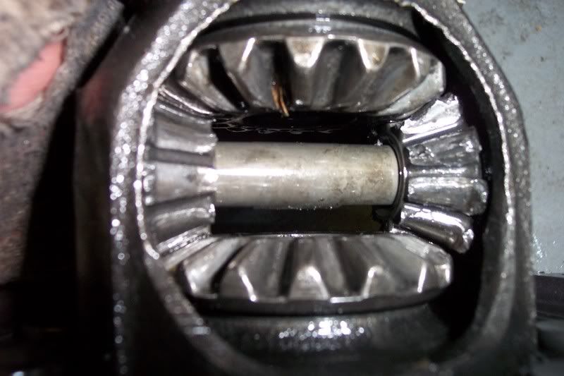

More chances of the F-series 1.8 tranny doing this though.
http://i116.photobucket.com/albums/o7/FunkRider/blowndiff003.jpg
(and no the side gears don't have small teeth... I machined them down with my right foot)
