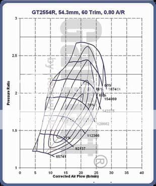

the t25 is a joke if you want to make more than 225 whp. the end. its a ******* hair dryer at that point. read a ******* turbo map and say i'm pulling s*** out of my ass then.
and by the way, if you want to run 14 psi on the unichip/AEM boost solenoid, enjoy the short ride.
and do me a big favor: link me two more build threads (i guess i believe 719, so two other ones) where they were stock motor and stock turbo and made over 225whp. there's not many of them. that turbo is too small for a 2.0L, it's already running out of flow capacity at 10psi, and its useless at like 14+. its sized more for a 1.8.

The stock turbo is a joke. Look at the compressor map. If you want 230+ whp the stock turbo needs to go.
Just for reference, on my T3 60 trim, I did 221WHP on 10psi and 190whp on 7psi. That was with a low compression built engine though. Try making those numbers on the stock T25.
I guarantee you I can turn down the boost 4lbs make 40 less whp. The stock t25 with a good fmic is still efficient past 10. This is why people whom have good info stop coming because of this s***. And if you really don't believe me go find some old 2nd gen dsm owner who was running 20lbs on their stock journal bearing t25. Making well over 225whp. Clearly if you have not done it, can't read compressor maps, haven't talked to Garrett/air research you should stfu because you clearly don't know what you're talking about. If 14psi was so inefficient why are my intake temps fine? Whatever clearly since I'd be the one making well over what you say I cannot I guess that makes me the winner.

It's not a good idea for said DSM owner to be running 20psi on a T25, either. The compressor flow charts distributed by Garrett themselves prove that. It's your dime when your motor blows. (Not if, but when.) But don't go around telling other people that it's just fine to do it. These cars blow up enough without misinformation being spread.

What are your intake temps? I want degrees measured directly in the manifold. Not just "fine". At that boost level the turbo is way outside it's optimum range, and is going to be blowing hot air. Methanol injection be damned.
