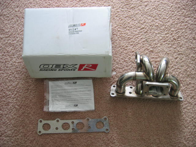

Dont get mad at me....I own a mx6 (same FS engine) and dont visit here TOO much but enough to search as much as I can. I even searched about this but came up with nothing. I read a little about how the 1.8 exhaust manifold will fit the 2.0 and vice versa but what about this - http://cgi.ebay.com/ebaymotors/ws/e...tem=7976751341&category=33742&sspagename=WDVW
Its a 1.8 liter turbo manifold but would it work on the 2.0FS? Any help/ideas are appreciated. thanks, Rory
Becareful with those OBX headers.OBX is an Imported line from China.The manifolds reek of low quality and design.I have seen MANY MANY Honda and Mitsh. guys fall for the cheap price and get stranded when the manifold breaks apart.Do a search on honda-tech.com to see some pictures that people have taken when their manifolds blew apart.
As for if it'll fit, as long as it's a 1.8L NON BP it'll fit.
