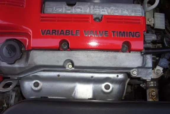

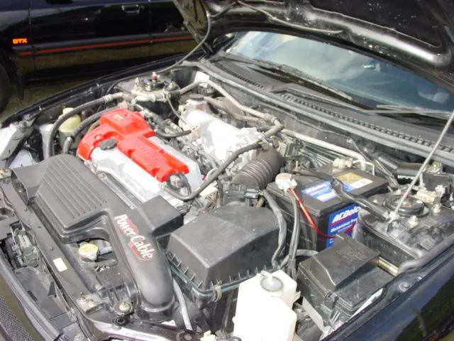

i have a 1998-9 mazda 1.5 5-speed real good pulls sweet planning to turbo it it,s a sweet motor,with shorter rods it, should be stronger on broost.
