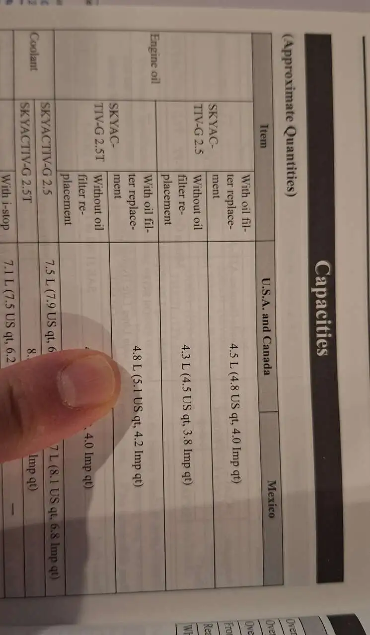

yes the dipstick clearly shows almost a liter over (3/16th -1/4" over top dot). Note 4.8 liter ... no reason 5.5 appears and I've questioned them and they swear up and down thats what my car takes. Despite the manual.

Unfortunately your Mazda dealer actually is correct this time putting in 5.5 quarts of 5W-30 oil in your 2.5T for the oil change. The oil quantity of 5.1 quarts listed in owner’s manual is “approximate” and misleading. All DIYers know they need to put in more than specified 5.1 quarts, with 5.5 quarts is the most agreeable quantity for the oil change on the 2.5T to reach to the Max mark of the dipstick. If the oil level on the dipstick is higher than the Max mark with 5.5 quarts during dealer’s oil change, the reason IMO is the tech didn’t wait long enough for the oil to drain. Most dealers use a meter with bulk oil and if the meter set to 5.5 quarts, you car will get 5.5 quarts.
I blame this confusion to Mazda as its fluid quantities listed in the manual are inconsistent. Engine oil capacities listed usually are 0.4 ~ 0.5 quart low for the 2.0L / 2.5L NA and the 2.5T.
My 2016 CX-5 2.5L NA needs 5.25 quarts for the oil change, but the manual says 4.8 quarts. Rear differential gear oil is listed 0.48 quart but it actually needs 0.7 quart. However, the gear oil needed for front transfer case is right on the spec, 0.48 quart.

your manual doesnt say 4.8 quarts. Its says 5.1. 4.8 is liters. I would call it quits too anywhere near max. Thats what the dots are for and 3/4 there seems perfect.

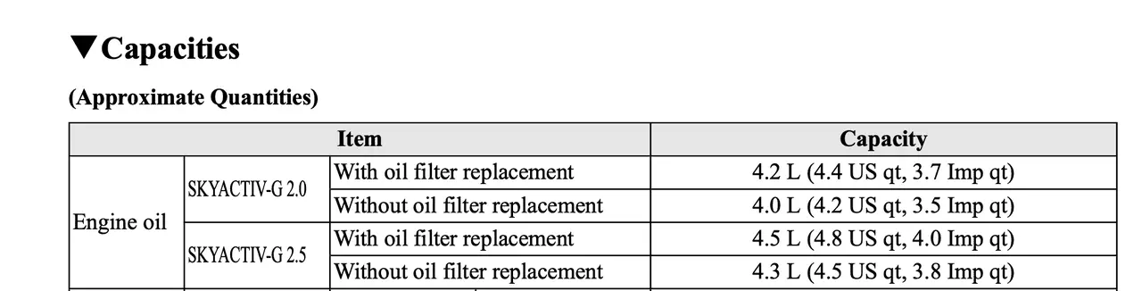

Screenshot of the 2014 CX-5 owner's manual PDF. My manual says 4.8 quarts. The manual is wrong. 4.8 quarts would probably only put it halfway on the dipstick between the two dots.
The manual is accurate if the target is the half way point.
