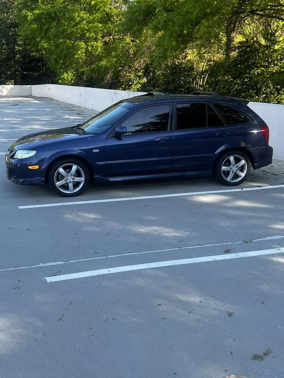

For anyone wanting an update. Got the tint done. I’m a construction manager so my car sits in the sun for most the day so I went a little darker to help with some of that
3 % brow
15 % ceramic driver and passenger
3 % all back windows
Why 3%? My shop doesn’t even offer 5%.

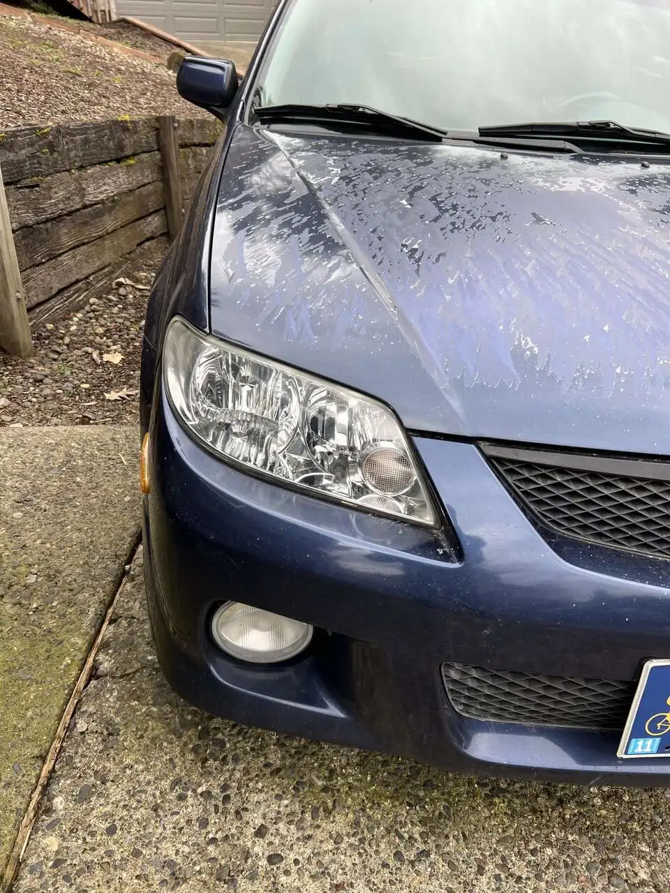

Aside from the P5 gradually flaking all clearcoat off with this weather, the headlights have been dodgy and yellow since I purchased the car. I finally sacked up and dove in and I am stunned at the difference. I have always loved 3M products, so I bought this very inexpensive kit on Amazon - https://www.amazon.com (commissions earned)
Frankly, they are stunningly clear now. Just shocked. I can't recommend this 3M kit enough. I also did one of the lights on my MSP and both lights on my CLK320 and there is a ton left over.

Aside from the P5 gradually flaking all clearcoat off with this weather, the headlights have been dodgy and yellow since I purchased the car. I finally sacked up and dove in and I am stunned at the difference. I have always loved 3M products, so I bought this very inexpensive kit on Amazon - https://www.amazon.com (commissions earned)View attachment 318601
Frankly, they are stunningly cldear now. Just shocked. I can't recomm,end this 3M kit enough. I also did one of the lights on my MSP and both lights on my CLK320 and there is a ton left over.

Those look great! I need to do this on my P5 too, and I might also try adding some clear film to protect them further in the long term.
